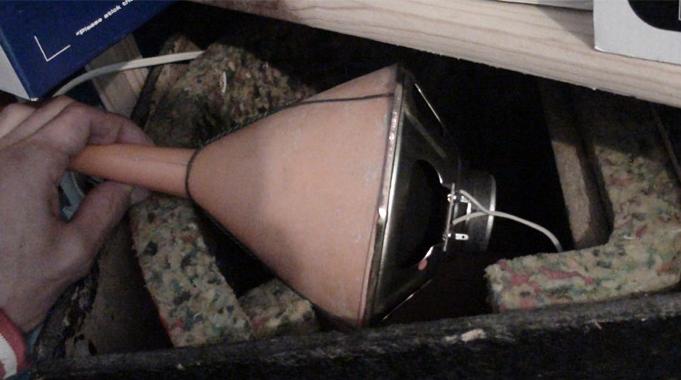

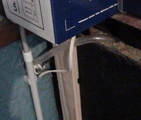

DANTE: Anyone know how to get the Bon Jovi talking guitar wah on Scope ? ATOM: You feed the guitar to a little speaker housed in a cone. The other end of the cone connects to a tube, transferring the sound to your mouth. You shape/filter/... the sound by changing your mouth's shape, then mic that echo back into the monitor/main amp. All the articulations are made by your mouth. Just take a speaker like from an old radio (3 to 5"?) and pipe it through. DANTE: The only thing I can add to what you're saying is that the piping of the sound to mouth then that sound back to cabinet seem to be one and the same pipe / electrical connection, e.g. it's not like one pipe in then another pipe / microphone output back - at least that's the way it seemed from the video, but I could be wrong. ATOM: The sound isn't traveling back down the pipe to the cabinet - it might but it's not being used, would be overruled by the dry sound anyways. A microphone in front of the mount captures the 'filtered' vocal sound, just like for singing, and is then recorded/monitored. DANTE: OK. A microphone in front, that's the piece of the puzzle I was missing. So you're working three things at once doing this trick. The pipe, a microphone and the guitar. ATOM: Dry sound to the speaker, through funnel and tube. Then mouth reflects 'formant filtered' sound back to mike, which is then monitored/recorded. Effect is like a light vowel-ish auto-wah. Had good fun with other 'echo chambers', too: Another funnel, coffee pot, my daughter's little plastic shovel, etc. The effect when sliding the chambers over and away from the tube exit/mike combo is more phasing/flanging, comparable to the sound of your footsteps when you're walking through an alley. I first had the talk box sitting next to me, but the direct speaker sound mixed in the mike, too much. So I used the spare hole in the wall to put the talk box in the next room, a small storage room where my DAW is, too. That did away with the talk box mess, and with the cross-bleed. |

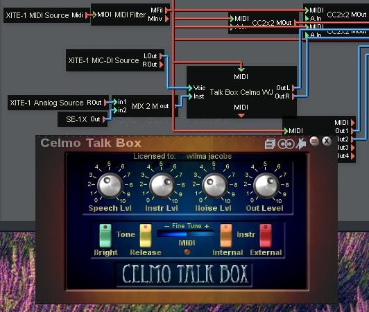

XITE-1/4LIVE: Or you could buy Celmo's Talk Box. It's quite authentic and works perfectly well on synths a la Rocky Mountain Way by Joe Walsh. Totally MIDI controllable, And as usual, Celmo's devices just work every time. | |||||||
