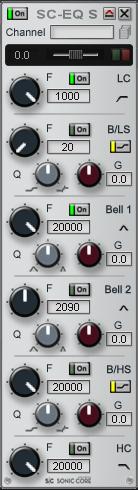

Dante:
So with quite a few equalizers already
included with
the Scope platform (STM built in graphical, PEQ-4, SL9000, 4-Pole,
Parametric etc), what were the primary
design goals of the SC-EQ that would make it stand out from the rest ?
Ralf:
It was designed to be an EQ in a
mixer (e.g. as a channel strip EQ), easy to use and good in
sound, but with no EQ graph, to save screen space.
Dante: So
what knowledge or tricks went into the design of the SC-EQ?
Ralf: Well, I can
not say, but it includes ten years of experience with filter development. The
parametric filters can be used with or without resonance and also
anything between, which gives you a wide range of sound
possibilities. Also it was built to save DSP cycles running as
a single module.
Dante: I notice that the
frequency ranges of the two parametric (bell) bands are totally user
selectable rather than giving users 'predefined' frequency ranges.
Was there a reason for this design?
Ralf: Yes,
we felt it would offer more flexibility for the SC-EQ to operate
with two filters with the same wide overall frequency range, since
the user could then use any frequency on each band rather than some
arbitrary 'built in' crossover point.
Dante: So
you would recommend this as the channel EQ of choice out of all the stock Scope
EQ's?
Ralf: Yes, trust your ears and how it responds to the
controls. The phase behavior is similar to that of an analog filter.
The shelf EQ curves handle a wide range of different EQ types, with
and without resonance and anything in between. Every normal
equalizer must have a phase behavior over the frequency (only linear
phase equalizers don't have). |
FILTER TYPE |
Low Cut 20 - 1,000
Hz |
B / Low
Shelf 20 - 10,000
Hz |
Bell
1 20 - 20,000 Hz |
Bell 2 20 - 20,000 Hz |
B / High Shelf 100 - 20,000
Hz |
High
Cut 2,000 - 20,000
Hz |
