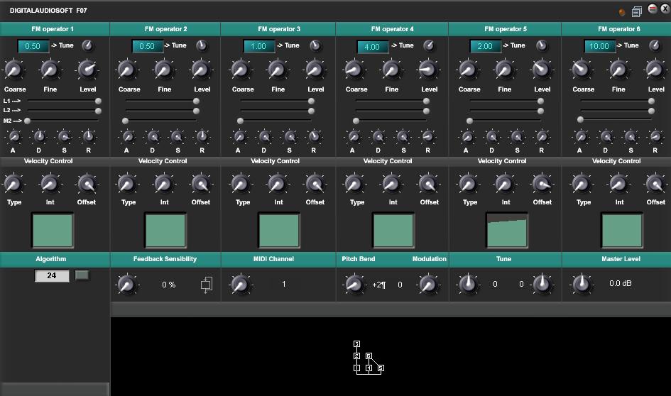

As a user of half a dozen key favorite DX7 presets, the question was how easy was it to reproduce these immortal sounds on the F07, given that the parameter structure of the F07 was slightly different than the original DX7.
The DX7 envelope structure consisted of four rates and four levels, rather than the traditional ADSR.  DAS addressed this the same way other native DX clone makers addressed it - by going back to the traditional ADSR structure for familiarity.  A good move for ease of use, but one which forces programmers to tweak the original patches in order to get them to sound the same.
To supplement the ADSR values, DAS also added three extra parameters, the L1, L2 and M2 sliders.  Experiment with these sliders to fine tune the output of carrier and modulator operators.
