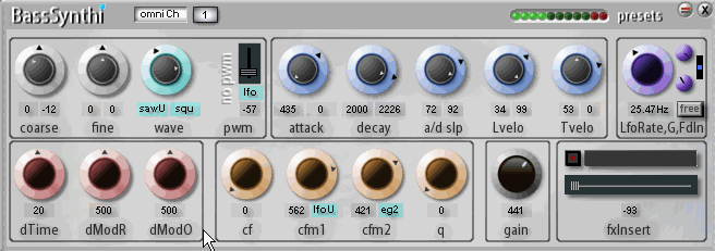

Roy: After DxSynth and Atze, I wanted to make a compact, easy-to-edit
synth device, which nevertheless should have a distinctive sound. By
fiddling around with the Modular Synth, I found a simple way to realize
Phase Modulation. Osc1 goes to a Modulation Delay, which delay time is being
modulated by Osc2. The output of both oscillators is summed, passed
though envelopes, an LFO, a low pass filter and finally the effects insert
and that's it! |
