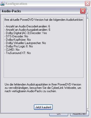

ok, maybe i can't read, but i think the line "Dolby Digital (AC-3) Dekcoder: Yes"
means that i have one.
And with other Soundcards it is working. (unfortunatly are the routingposibilitys of the used motu 24IO very bad)
- PowerDVDconfig.jpg (22.93 KiB) Viewed 2181 times

Yes, if the soundcard has the decoder chip, then PowerDVD will work.christsuch wrote:And with other Soundcards it is working.
If someone can find a way to trick SPF to decode encoded material as it gets streamed to the player, then that would be cool.
