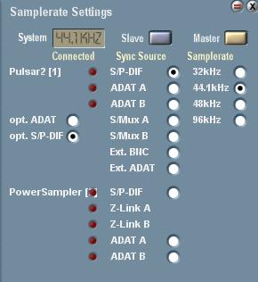

did you try to make sure that the cable from the expansion plate is still well connected after you add the pulsar.
as adding another card should not make a plate disappear. that is strange
did you try reinstalling the software so it detect All I/O
you should see something like this
sample rate.jpg (13.24 KiB) Viewed 1702 times

Yes, what is most strangest, I see just picture you sent, in samplerate window I can see ADAT physichaly connected, but in hardware devices, there is no ADAT devices for Luna :-?
