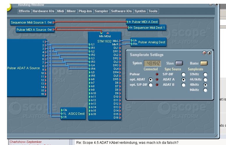

howe can I use the ADAT A In OUTs by Pulsar 1 v 4.5????
hello, Im from germany and Im new here, sorry about my bad english.

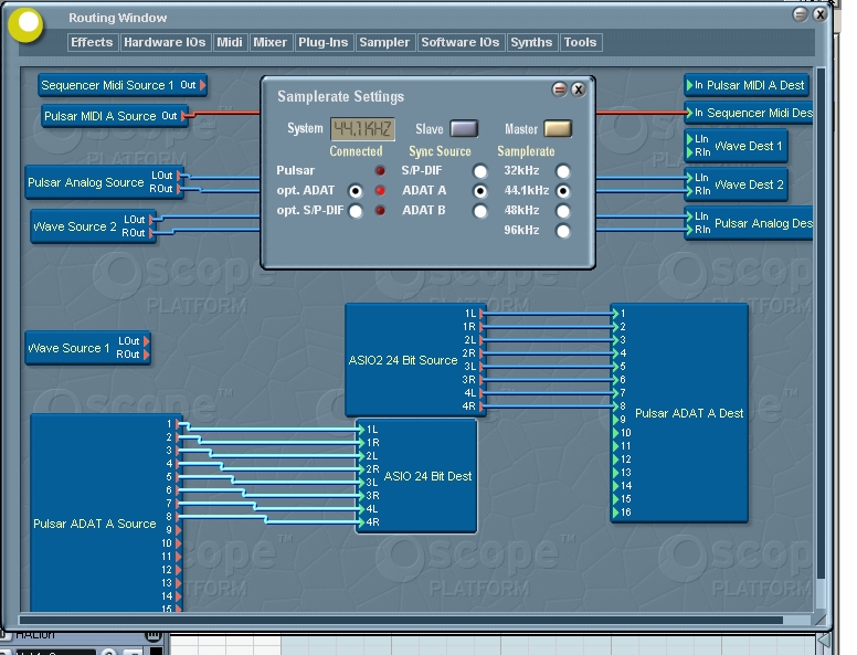

I have a Pulsar 1 Soundcard in my PC, and a Digital Mixer Roland VM3100PRO with Digital ins and Outs , as SPDIF In OUT and ADAT IN OUT, Im buying TOSLINK Kables ,So Im take the internal clock as Scop , but I cant see any signal on my Mixer, I turn the Clcok by my Mixer of DIGITAL B, this the DIGITAL OUT and IN for ADAT, and the clock for SPDIF is DIGITAL A, I have any signals on my Mixer of digital ADAT way, WHY, what I have made wrong??
Its do not work,too if I turn the Clock on my Mixer on Internal and turn the Scope of Slave!!
Howe is the ROUTING WINDOW Screen to look to use the Scope with 8 ADAT ins and OUTS and to use with Cubase SX3 togehther with my digital Mixer roland VM3100 Pro???? ist the screenshot that you see okay??
please help.
greets.

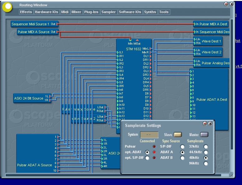

- Scope Platform mit ADAT A IN OUT und ASIO2 DEST.jpg (239.14 KiB) Viewed 3103 times
- pulsar scope routing window.gif (101.16 KiB) Viewed 3103 times
I don`t know but you could try to use the asio 24 bit modules, maybe the roland needs 24bit to work with....
look for asio 2 24 bit source and destination module.
not sure if it helps, but at least its worth a try... maybe...
othere than that I think your connections are correctly.

Hi & welcome.
Spdif & adat in your Pulsar<>Mixer setup run off the same clock source, not separate. Setting up digital systems (no matter how small) often requires a little trial & error, so what I would do is verify that you can get the adat link functioning properly @ 44.1 khz to begin with. I would completely disconnect the spdif cables, leaving yourself with just the adat to get working primarily. It should work in either direction in theory, but after doing the above, I'd also suggest setting the mixer to internal clock & Scope to slave (just to begin with).
Basically, start with the basics, which should really be the adat link since it gives you 4 x the number of outputs from your mixer compared to spdif. Try to get that functioning to begin with because starting with bi-directional adat & spdif all connected at once is not a particularly good idea.
Well, it's not much, but hopefully if you do as I suggest you can quickly get a basic working setup, which is a good starting point.

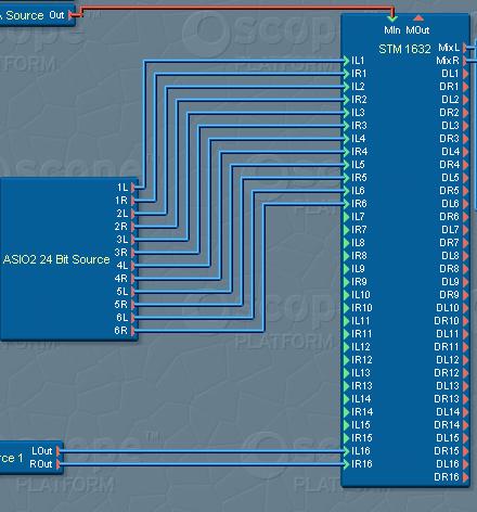

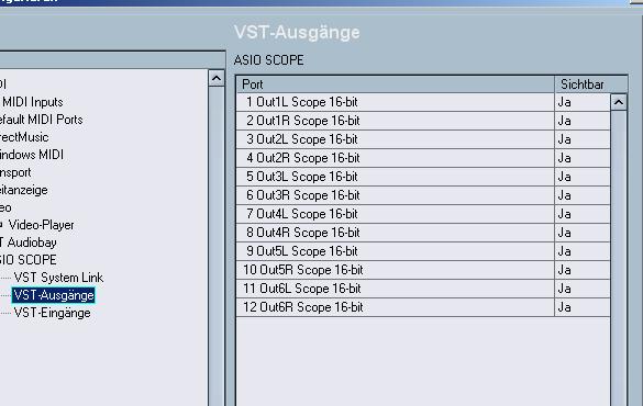

thank you very much for all the answers, so Im change the ASIO from 16 bit of 24 ASIO DEST and Sources, so I can see that the ADAT A Led is RED (screenshot 2) but I have no signal in my mixer,if I make the scope to MAster Clock I can see ADAT Signal in RED , but If My mixer is on INTERNAL CLOCK and the Scope is as Slave so I cant see the RED Led on ADAT A, if Im starting cubase I can never find the 8 ADAT outs to rout my cubase cannels over the ADAT line to my mixer (screenshot 1) , I see there only OUT L SCOPE 16 Bit and OUT R SCOPE 16 Bit!!! Where are the ADAT lines to see??? And howe can I change the Bit range, I see everywhere by cubase 16 bit, but I have to work about 24 Bits becasue I chnage all the ASIO Moduls of 24 bit !?!?!
- asio 24 bit configuration.jpg (281.26 KiB) Viewed 3075 times

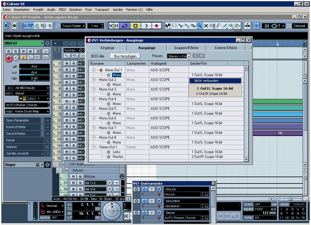

- I can not see where the ADAT outs in CUBASE is!!!.jpg (558.11 KiB) Viewed 3074 times
at first I would set the sampling rate to 48khz as the Roland works at 48khz too...
then restart cubase AFTER you have loaded the scope project.
the go "vst audio bay" in setup area and reselect asio scope.
for a first try don`t load "old" cubase projects, so you don`t mix up the outputs with an old setting.
Then look under VST-outputs and your 8 scope mono/4 stereo channels should be listed correctly.
Try this and post your results again.
(BTW normally if the master slave clock thing is setup wrong you only get clitches and pops. so you will hear when the clock sync is not correct.)

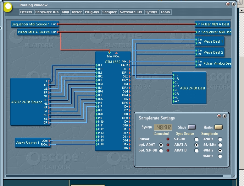

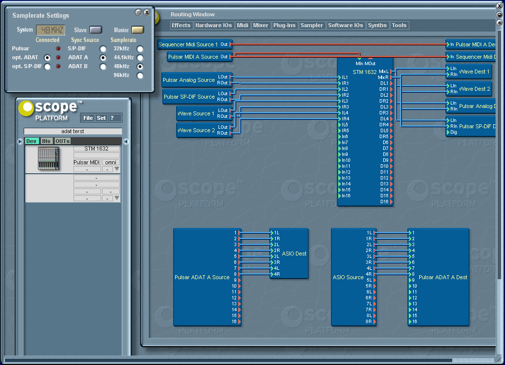

hello again, now I build the scope routing window of 24 bit ASIO Dest, you can see now the the scope is here as Slave clock running, my mixer is MASTER, the ADAT A LED is RED, but now has the Cubase problems, you can see the screenshots ,all the error messeges, if I turn the scope as Slave so Cubsae can not find a Audio device and ist turn it on ASIO Multi Media driver, and If I wants to shange this of Scope ASIO so it not work, I can not change this, the scope ASIO is only thna to see I f I selsct the Scope as MAster and my Mixer as DIGin-B (B= ADAT in from my mixer) but so or so, I have no signal, no sound. The cubase playing the sounds if the scope is as Master clock running, but the sound do not coming to the mixer , ans I can not find the ADAT outs in Cubase sx3, I see only 8x mono Outs ore 8xstereo Outs, I can see 8x Scope 16 bit Ins, but nowhere is Outs to see^^
- scope adat 24 bit dest and source+mixer.jpg (301.09 KiB) Viewed 3009 times

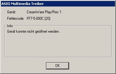

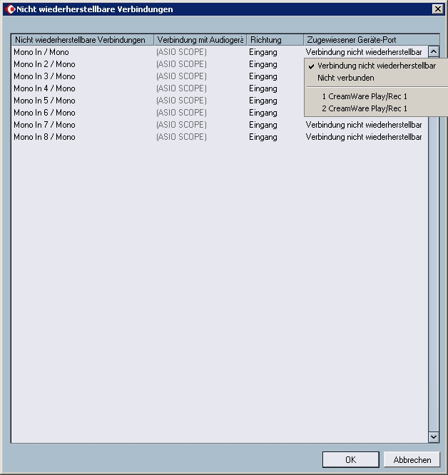

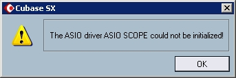

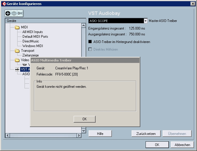

and here are the error messeges if I want to turn the ASIO Multi Media Driver to ASIO SCOPE Driver whne the Scope are running as Slave:
- the first error messege if I turn the cubase sx from ASIO Multimedia Driver to ASIO SCOPE.jpg (29.08 KiB) Viewed 3005 times
- the second error messege if I turn the cubase sx from ASIO Multimedia Driver to ASIO SCOPE.jpg (130.04 KiB) Viewed 3006 times
- the 3. error messege if I turn the cubase sx from ASIO Multimedia Driver to ASIO SCOPE.jpg (21.72 KiB) Viewed 3005 times

diese ganzen Fehlermeldungen hast du doch vorher nicht gehabt? also ich meine mit dem normalen ASIO Device.
stell also mal wieder auf "master" zurück. Sonst ist gar keine SamplingRate gesetzt.
mal ganz unabhängig von deinem Digitalmixer, steck doch mal den ADAT aus und schau das du folgendes Projekt konfigurierst:
So ein Problem muss ja nicht unbedingt international gehalten werden.
sonst wirds mir zu kompliziert....
- project
- routing.JPG (37.57 KiB) Viewed 2995 times
- so sollte cubase das erkennen
- channels.JPG (36.17 KiB) Viewed 2996 times

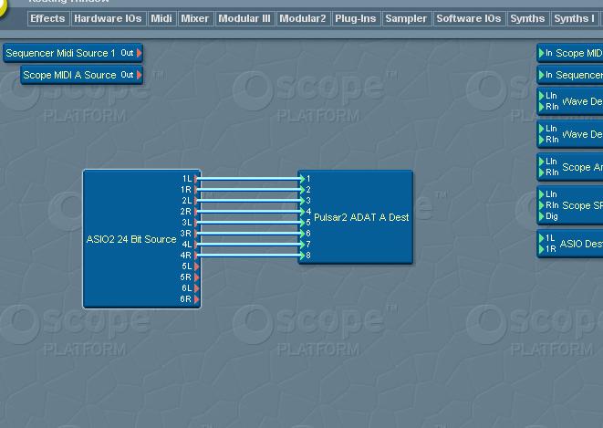

wenn du das hast,
- ersetzt du den STM Mixer durch das ADAT Dest. Module und routest die Kanäle getrennt zu den ADAT outs.
Dann steckst du deinen Mixer per adat an den scope out und schaust das du die einzelnen Kanäle in dein mixer reinbekommst....
Das müsstest du ja an den PeakMetern am Roland sehen.
Danach kümmerst du dich u die ins....
step by step...
step by step...
hallo hifiboom, schön das es hier auch deutsch gehen kann, ich dachte ich bin ibn eine amerikanische forum oder so wo nur englisch geschrieben wird, mit meinem bad english ist echt schwer, also ich habe nun soweit eingestellt wie du abgebildt hast nur die screenshots sind nicht ganz zu sehen, wohl fehler beim hochladen, was ich gerne wüßte ist wo bitte ist der ausgang L-R von der STM 16-32 Mixer angeschloßen was ich hier nicht sehen kann?? an einem ASIO 24 BIT DEST???
hier senden ich dir noch den screenshot von der neuen konfig. wie du meinst auch hier null ADAT signal, auchn wenn der scope als Slave und der roland mixer MAster ist, oder umgekehrt, kein signal kein led kein ton^^
- neue konfiguration, hier ist kein ADAT Led an!!! auch wenn ich den Scope zum Slave mache!!.jpg (293.71 KiB) Viewed 2983 times

egal, mit deiner obigen Konfiguration siehst du jetzt hoffentlich die einzelnen Ausgänge in Cubase? Und hast beim starten keine Fehlermeldung?
Wenn ja dann probier folgendes.....
bekommst du damit was auf deine Mixer Kanäle wenn du die Scope Asio Kanaäle in Cubase getrennt adressierst?
Wenn sich da jemand aufregen würde, darf man das getrost ignorieren.
(tut aber niemand.)

hallo leute, ja da bin ich aber beruhigt
Also ich habe nun die von dir zu letzt engbrachte routing system ausprobiert, hierbei leuchtet nun der ADAT A überhaupt nicht mehr, egal wie ich es umstelle, ob scope nun master ist oder der Vm3100pro bleibt sicht gleich, auch 44 khz oder 48 hilft da nicht, habe nun auch die ADAT B ausprobiert , geht auch nicht, wenn ich die Mixer Clock umstelle auf DIGITAL In B oder DIGITAL A beklomme ich immer die gleiche meldung bei der mixer: "Digital In Cheking "und darauf zufolge kommt dann die resultat: "Digital In Unlock (Temporary INT.)" , nur wenn ich den mixer aufInternal umstelle bekomme ich keine meldung wie DIGITAL UNLOCK oder so was, und mit der SPDIF kabel den ich ja nun nicht mehr drann habe hatte ich mal die meldung "Digital IN Locked" und hatte auch sound hier drüber zu hören über Cubase, aber bis jetzt noch nie über ADAT.
aber eines muss ich noch sagen , ich habe nun bei cubase die 8x 24 BIT digital ins und 8x digital outs zu sehen
nur immernoch kein sound auf meinem Mixer
, ein bissl vorran sind wir schon gekommen jungs
