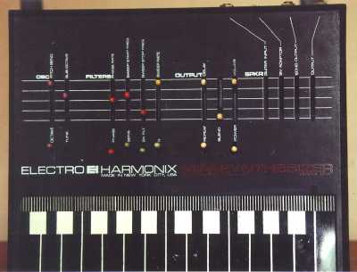

btw, do you think this EH guitar synth looks like a cross between an EDP Wasp and an Arp?

Don't read into things too much, it's not healthy Martin. :D
Thanks a lot btw! This a seriously cool device.
