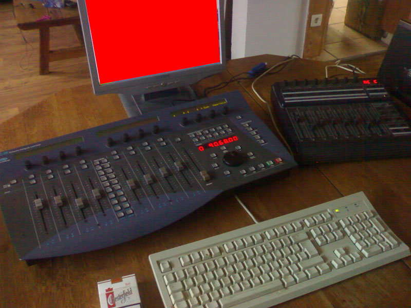

hi
in fact i have a SAC2K, which is the old version of the SAC 2.2 but quite the same ... same functions, and i think, same templates ...
i can say that it is a very good product ... well made, well designed, very good component ... nothing to say, except that it doesn't work via USB, i
need a "special" USB wire, that i am still waiting for, from RADIKAL ...
Peharps jimmy you got it ???
anyway it works fine via standard midi pots, in out thru ...
i also own a behringer BCF 2000 and let's say that the SAC is much much better looking than the BCF !!!
the BCF looks quite "cheap" in my studio while the SAC is very "high class"
But i have to say that from a developper point of view, the BCF is much better ... in fact it IS programmable, the SAC is not !!! No Flash memory, no
way to build a user preset ... no user preset !!! the only templates avaible are stored in the ROM and you can not have acces to any features, except
some very simple ones such as midi channels and few settings for motorised faders , leds blinking ...
so you have choice between few "modes" Standrd Midi, Logic audio, Logic control, Mackie control, Protool, ... and PULSAR ...
the fact is that when you need to use it as a controller for NUENDO (i only tried this one ...) it is fantastic , in few modes, Active or Mackie ... it
works perfect ... and the size of the board, the motorised faders, the LCD ... every thing is ok, much better than the BFC ... you also have very
explicit, transport section, easy to use.Some free assignable buttons ... for vsti, mixers ... + a very good looking stuff, that can take place in a
studio .

- SAC VS BFC
- SACVSBFC.jpg (108.56 KiB) Viewed 3638 times

hi tau,
it is a great stuff !!!
unfortunately with some limits!
i am ATM using it a lot in studio as a controller for Nuendo ! and i must admit it is amazing !
i route it via scope midi (to midi seq dest and from midi seq source ) and it works perfectly .
unfortunately as i alredy told it doesn't work in USB here !!! only standadr midi cables.
i have ordered the original midi cable at radikal since months ... but still nothing , i think that they are out of support on this product .
with nuendo, i do not use mackie control, i use the "standard mode" (sorry i don't remember the exact name as it now recognises it automatically each time i launch nuendo)
i have mixed a whole disc 2 weeks ago and i was very very happy with the controller ! since more than ten years i was so used with "mouse mixing" that i didn't think i would have keep it but after few experiences, i must admit that it would be now difficult to work without it !
very intuitive, transport, faders, pans, and even eq, inserts ... everything work perfectly ... hat off !!!
i made today this afternoon 4 vocal recordings at studio and even in recording it is amazing ...
here are my experiences ...
here is my conclusion ... Kool stuff
cheers
olive

- sac5.jpg (360.07 KiB) Viewed 2834 times
Hi Olive! Thanks for your words!
it really is great! I was fortunate enough to get the original cable with the unit from ebay - and it just won't work with any other of these USB cables that I have, no matter how I set it up in the control panel - no cable, no SAC...
Cubase (and Nuendo too, I guess) have direct support for the SAC, so standard mode is OK. I tried it like that as well, but found it easier to work in mackie emulation mode. For Live, it's a breeze, as you can really get inside the plugins and tweak away at your content, and in Cubase too, you can access EQs, inserts, sends, everything.
I believe that the virtual drivers are only available when you use it via USB, but there should still be some bonuses in MIDI mode, like loading separate editors on the instrument slots. But the manual I have is really "light", and things just don't make enough sense to figure out how to use them.
And contacting Radikal seems to be a waste of time. Good thing we got Z!
I believe, though, that these special USB cables might be available from other manufacturers. The one I have is actually branded by Radikal, but although it looks like an ordinary cable, it also has some other info printed that might help you find a replacement. Here's what it says:
"Radikal Technologies SAC 2K USB cable 2.0 revision 26AWG/1P and 20AWG/2C E179993 (UL) Type CM 75ºC SHIN AN -C- "
After getting this to work with more than one app at a time, I can only reccomend its USB connection. I really hope one that can still find a replacement for the cable, otherwise it'll be a sad future for the SAC. Heck, I'd buy an extra one if I had the chance!
Once again, many thanks,
