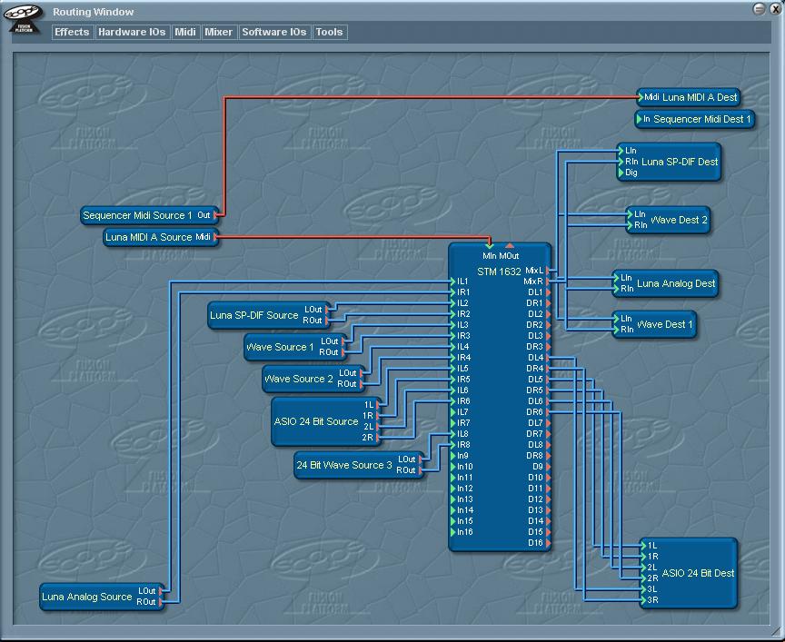

I will upload a picture of the Routing Window.
maybe you could tell me if I did something wrong, or recommend me a different setup.

your asio dest is connected to some odd direct outs. what are you recording there?

garyb wrote: your asio dest is connected to some odd direct outs. what are you recording there?
Recording sounds from movies directly to the host, kinda messy I know...:X
could you upload a simple default project for best quality or picture of it?
do you see anything wrong in my project or my connections that should cause Luna to record only the left side?
