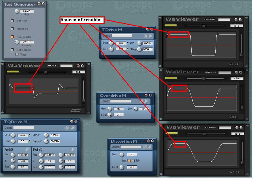

sorry but i have to add a 'first hands experience' here;
this is 'normal' digitaldistortion;
and you see the source of trouble;
thers not much man can do;
adding pre post EQs
splittin in bands;
add compression;
but the trouble stay!
it gets wors the lower the frequency is;
worst case is a bass;
tgstgs

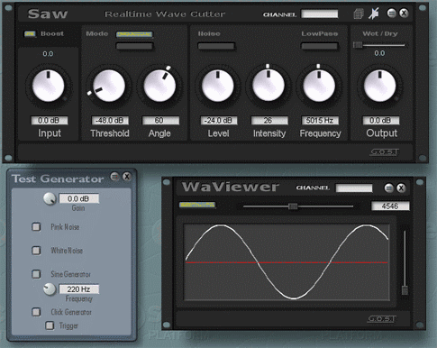

SAW uses different technologie:
the lower the frequency the better and different it sounds;
with threshold / angle and wet/dry you are able to cut the wave in a lot of forms;
and there is nothing filtered or comprest;
its just cutted away thats it;
to do different cuttings on different bands put a few in a dynomic;
so its up to everyone to tweak around for weeks to get near to . . .
or use a few parameters to get a unique new sound in realtime;
good vibes
sorry its a gifmoster -> i reduced a bit

These take zero DSP, are they run off of the host?
tgstgs
Posts: 526
Re: the HUGE distorted bass sound for metal:how do yo obtain it?
Post by tgstgs »
as you like;
the xrasterfader full to left makes it static full right is realtime;
but these are old versions;
i gave to all customers who pmed me corse we made SAW plug with it;
so it somehow belong together;
new one has more features;
save capturing as wav or txt file for further analysation just to name one;
sorry for off topic;
good vibes
Let me know what the A6 looks like through this, as I used my Analog synth in the jpeg.
Samples are displayed with much more space between the waves. And easier to seperate.
