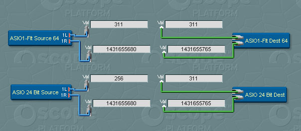

ReD_MuZe wrote:you need to set your project to be 32bit float in project settings
That did it! Now it no longer truncate to 24bit for 32bit float.
32bit float and 24bit int has the same resolution at high levels, but 32bit float has betters resolution at low levels - Nothing new here.
But why do 32bit float have the same resolution as 24bit int, when 32bit float can have greater precision even at high levels as shown earlier?
Thats because Scope use 'non-rounded 32bit float' and not 'rounded 32bit float'.
Non-rounded :
0,66666667 = 1431655765 = 1010101010101010101010101010101 (31bit) => E/-1 M/01010101010101010101010 (32bit float)
That gets translated back as 1010101010101010101010100000000 = 1431655680 (just like 24bit int)
Rounded :
0,66666667 = 1431655765 = 1010101010101010101010101010101 (31bit) => E/-1 M/01010101010101010101011 (32bit float)
The last digit is different in the mantissa, since we rounded up because the next digit in the 32bit is "1".
That gets translated back as 1010101010101010101010110000000 = 1431655808 (which is different from 24bit and non-rounded 32bit float).
1431655765 (32bit) - 1431655680 (non-rounded 32bit float) = 85
1431655765 (32bit) - 1431655808 (rounded 32bit float) = -43

Mike Goodwin wrote:So is that little understated sentence up there saying "they're perfect - no errors" to say that if I use the 32-bit flt ASIO drivers in Scope I can record into my host (Ableton Live) that uses 32-bit flt with no errors?
No - only the pure 32bit int drivers is without errors.
The 32bit flt drivers is second best.
Mike Goodwin
Posts: 170
Joined: Sun Dec 02, 2007 8:42 am
Re: Another thread about summing in scope
Post by Mike Goodwin »
Warp69 wrote: No - only the pure 32bit int drivers is without errors.
So the only way to not loose data is to use a host that supports int. Otherwise no matter what when you go from the internal int. environment of scope into flt. you loose some data. And as previously determined in this thread between 24-bit and 32-bit it is just different data that is lost. 24-bit favoring the loud portions of audio and 32-bit favoring the quite portions. I hope that I have this all right this time :l

Mike Goodwin wrote: So the only way to not loose data is to use a host that supports int.
Yes, 32bit int and only 32bit int.
Mike Goodwin wrote:Otherwise no matter what when you go from the internal int. environment of scope into flt. you loose some data.
Correct.
Mike Goodwin wrote:And as previously determined in this thread between 24-bit and 32-bit it is just different data that is lost. 24-bit favoring the loud portions of audio and 32-bit favoring the quite portions. I hope that I have this all right this time :l
Wrong. 32bit flt can represent every 24bit number AND more.
So for best representation of Scope audio :
1) 32bit int
2) 32bit flt
3) 24bit int
4) 16bit int
