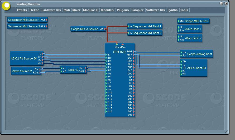

Hi m8,
What you would have to do is to setup a Scope project with audio driver you wish to use with your standalone plugs : ASIO or Wave Source devices in Scope.
If several plugs at the same time, then only one ASIO source and several Wave sources.
You have to be aware that if you wish to have let's say more than 3 VSTis active at the same time, you'll need to setup more virtual Wave and Midi modules on the Board's driver in Windows device manager (I guess you work with Windows).
As it's live then MIDI control over the VSTis so you need your Hardware MIDI IN module in place and connected to one or several Sequencer MIDI Dest modules.
Then I'd say a Scope mixer and plugs in or out of it.
At last, the main outs of the Scope Mixer to your monitor board's outs and that's it...
You could also put every plug you need in Cubase and have separated outputs from Cubase ASIO to Scope mixer and hardware Midi In plugged to Midi Seq used by Cubase. Personally Cubase way is my preference...

- Multiple sources and midi:
- sev_plugs.JPG (67.33 KiB) Viewed 807 times
