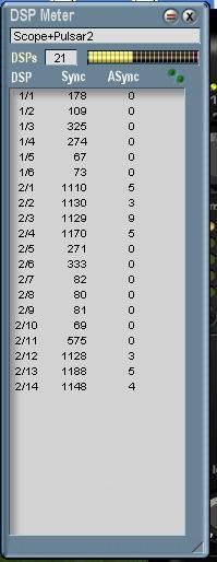

Here's my own meter, with similar board config. Project plus 2000-era Scope SP with 15 physical DSP chips. One of the chips does not show up in the detail, but does show up in the total DSP count.

yes, your DSP is working, on a 15 DSP card one does not show up on detail, its for "housekeeping"
my pulsar2 has 7 dsp, but who ever heard of that
and i have a actual 15, and a 14 (with a space for another) and both of them show up with 14
i get 6 and 14 and 14 (34) on the detail but 36 DSP in the total.
