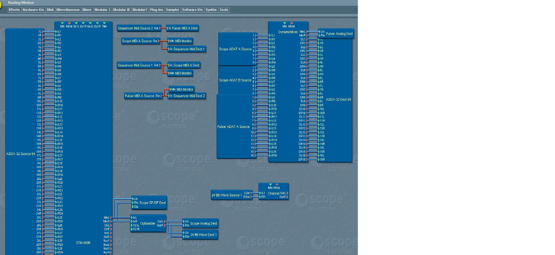

Re: digital grunge when wav recording
Below is a big-ol screenshot of my main project setup.
Noise remains with SPDIF disconnected. Already tried that. I also get the same result with Optimaster taken out of the main output.
During tracking Scope is slaved to Yamaha 01V96V2 mixer, and during mix Scope is master (tried it either way with same result).
Most monitoring is doing via analog.
2nd instance of Samplitude (mixdown) sees wav dest module as singular wdm input while main Samplitude project is ASIO. (This may be part of the problem, but it shouldn't be).
I've tried capturing at 24-bit instead of 32float, tried direct path out to Samplitude as well with same result.
Next step will be to just route back into main Samplitude project and mix to another track. I'm really only testing out using Optimaster in-line on the main output at this time.
Any further enlightenment is appreciated, as I'm probably forgetting something with the Yamaha, or just simply dealing with something leaking into the mix post-Samplitude.
