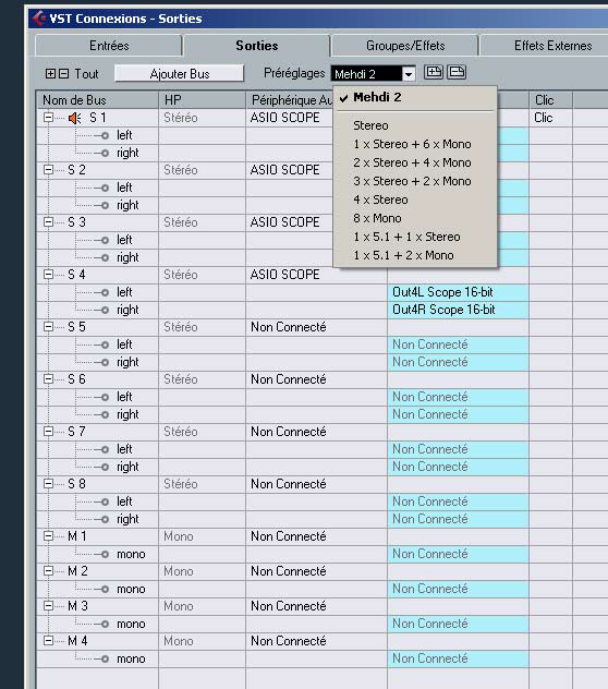

hi ,
in fact i meant the other window with all the i/os in french it is called "vst connexions" and is accessible with the "F4" key.
I think it is something added since cubase SX 3 or 4.
before it was like db mac said (or i don't remember having to do all the stuff described below:).
Cubase is touchy because you have to make your own preset, and unfortunately, this preset is on a project basis rather than in general preferences. if you change the number of asio i/os in scope, you will have to add busses in the vst connection thing and it is quite annoying at first, especially when you don't know what is going on.... I didn't think i was a beginner on cubase or daws in general, but this bugged me a lot at first and had all kind of weird behavior when using cubase own presets... If you load an project made with an older version of cubase, it will be messy and you need to check those vst connections if something is wrong....
if you put less asio channels in scope, then it will be ok (like in the picture where some busses are "not connected" .
It is the dark side of cubase ....
