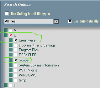

Hi all,
There is no pop up anywmore with 2 conditions:
- 1 -- when you set the "Search Options" (LiveBar - Set/Search Options... ) to look into the different/adequate folders (Thanks RP100 for the reminder
- 2 -- There are no duplicate entries (otherwise the search result ask to choose between 2 or more devs of the same name).
It's a lifesaver to set those.
I hope it helps.
I hope it helps.
- For BB2, Add the "C:\Creamware\ folder after applying the patch
- Search.jpg (54.68 KiB) Viewed 24285 times
