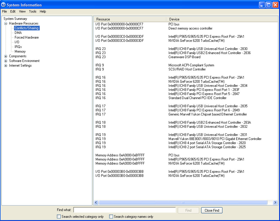

Ok.garyb wrote:go to start/programs/accessories/system tools/system information/hardware resources/conflicts-sharing and tell me what, if anything, is sharing an irq with the Scope card.
Here is a screenshot of the IRQ-ports. This is out of my knowledge, is it possible to fix the freeze-problem somehow whitout installing old drivers for scope-platform?
btw, i have a dual core processor.
Thanks for your fast reply
Regards
Johan

Re: Computer Freezes - What to do? experience of this?
disable the two usb controllers on irq 23(numbers 2830 and 2836) in the device manager.

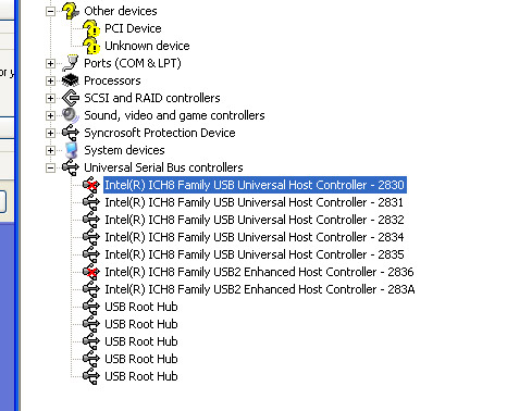

done!garyb wrote:disable the two usb controllers on irq 23(numbers 2830 and 2836) in the device manager.
Garyb, is the freezing a generally error when "devices" share irq-ports?
I guess its just to wait now, and see if the problem is gone.
Thank you very much.
