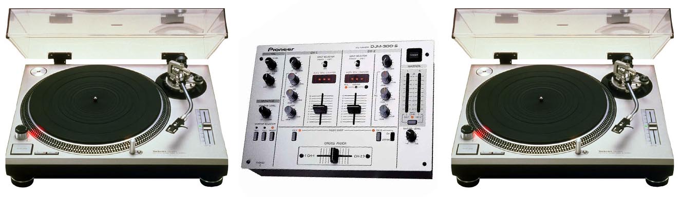

I still have a set of 2 Technics MKII (silver ones) lying around and a pioneer djm300 mixer, all in very good shape and would like to sell it. But it's too expensive to ship to Las Vegas I think... However, whole set would be 1000$ plus shipping...
Cheers
Roman

Re: Calling All DJ's
That's a good mixer to learn on as long as he's not trying to learn to battle/DMC (scratch) as the fader isn't up for it, it will last for home use. For 'straight' mixing (house/trance/techno/etc) it's got a clean signal path and the eq's function the same as mixers you're likely to find in the club. For any serious 'club' or 'party' use (ie, carted around & used a few times a week by more than one dj) he'll eventually need something more. Also if he's going to be carting turntables and a mixer around he'll eventually see the need for crates or a coffin (which can either be independent per turntable/mixer or unified for all 3.)
A lot of 'budget' mixers try to cater to the scratch crowd butl have shitty faders and build that won't last a year under that kind of use. They'll last ok for bedroom dj's but many add eq 'cut' features that kick in an extra cut at the end of the travel or have buttons for very steep eq cuts/crossfader cuts etc that will wear out fast. They makes straight mixing a bitch since the phase-shift results in a carefully aligned mix being noticeably off.
