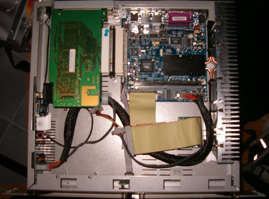

By the way, this project is in progress, here is a picture of the internal with the new IDE to CF interface (hidden under the IDE harness ...):
inside xite_0_04.jpg (144.22 KiB) Viewed 1768 times

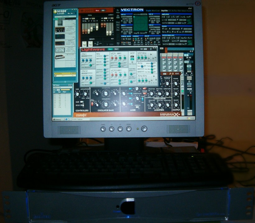

Ok, so last update to my "Xite 0.04" was to change the Pulsar 1 SRB with no plug for a Pulsar II with some nice one.
So now it should be called "Xite 0.06" !!!
Here is a picture of the system running silently (except for the noise made by the synths)
Fanless PC with 2 scope boards:<br />- 1 old 3 DSP Luna <br />- 1 6 DSP Pulsar 2
- 1 old 3 DSP Luna
- 1 6 DSP Pulsar 2
xite_0_04 to xite_0_06 upgrade .jpg (113.28 KiB) Viewed 1577 times
