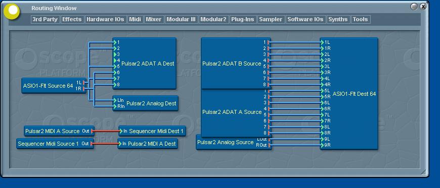

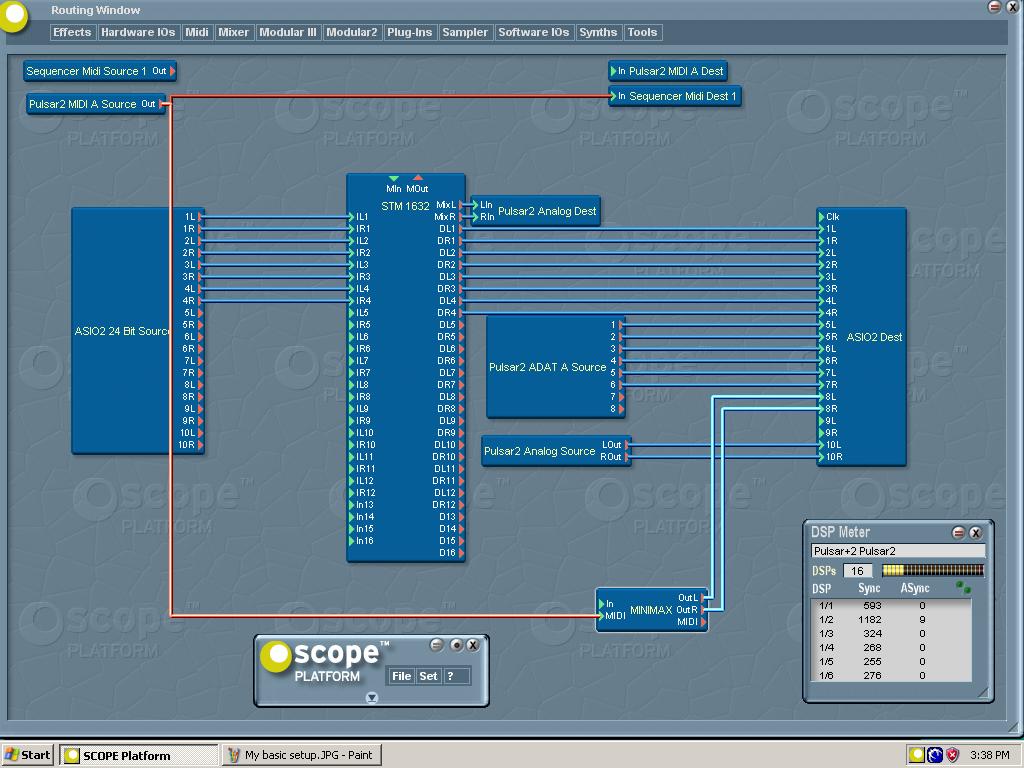

Here is a screenshot of my basic setup. Please don't laugh. For the time being it will do and allows me to record. I am sure I am not even scratching the surface.
I would appreciate some comments. As you can see my DSP load is very low, which makes me think I am nowhere near exploiting the full capabilities. Also makes me realise that I maybe shouldn't worry too much about not having enough PCI slots in future motherboards.
Can anyone see by this setup why I can't get MIDI from my sequencer to talk to my Scope synth?
Thanks to all and have a great 2010

Re: Is Scope (PCI Card) Obsolete? Revisited.
To trigger your Scope synth by the sequencer, you must link 'sequencer midi source' module to the synth... And set the right midi channel, output in the sequencer.
disconect Pulsar2 midi source out and Minimax
(keep the connection from Pulsar 2 midi source to sequencer midi dest)
Connect Sequencer Midi Source 1 to Minimax
In your particular sequencer - set midi out to Scope/Pulsar

Hi
Thanks for the quick responses JoPo and Feg. It worked. Hoorah!!! Simple when you know how. Though I am sure I had already tried that combination. Maybe I forgot to configure the out signal properly.
There are many ways to do things - none any more right or wrong than any other. Personally i would route Minimax to the STM mixer and listen to it with all your ASIO outputs going via STM as you've got as a final mix. Then just record the MIDI in your sequencer and let it play Minimax 'live' each time. If you want to set the Minimax audio in stone then by all means record it later as a separate audio track, but until you're 100% happy with the mix why commit? i would probably route the ADAT sources into the mixer too and then just do a stereo mix through Scope onto two tracks in Abelton.
