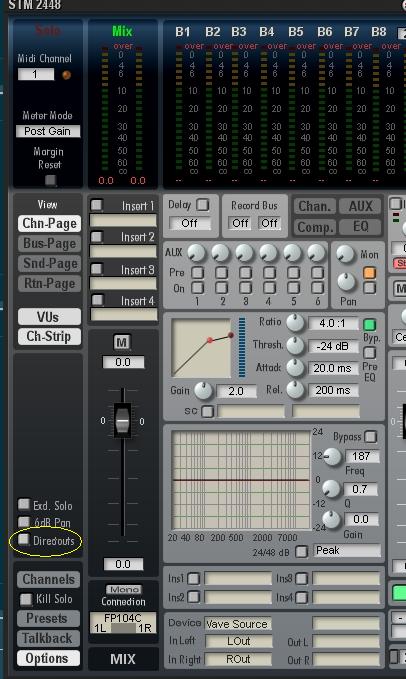

hi Fluxpod thanks for the reply....
1. I started with what you show me but I stuck with mixer output function.
when I'm open the STM 2448 it's show me only the defult outputs, how do I adds the rest outputs like you did?
2. do I need to make some changes in the cubase or in the STM 2448 for that?
iSiStOyyyyyyyyyy .............would like to hear you to.
thanks!!!!!

Re: Connection between vst in the cubase & the pulsar!!!
To see the STM direct outputs in the project window, you have to click (see image) -> then you can link the cables and if you click again on it, the outputs / cables disapear but remain linked :
- STM.jpg (62.28 KiB) Viewed 1965 times

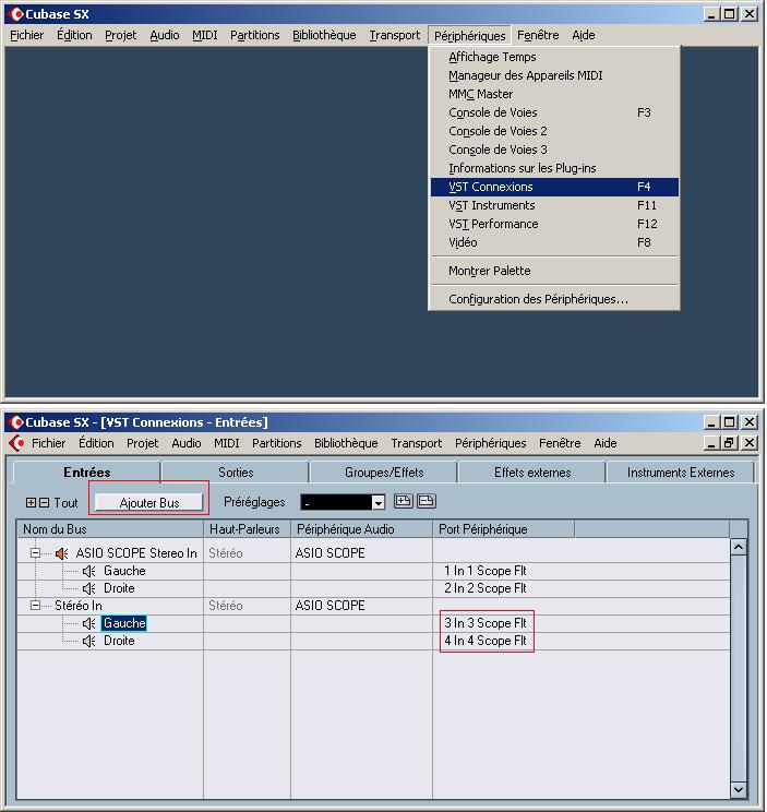

Did you add inputs and outputs under vst connections in cubase?
- Posts: 11
- Joined: Tue Jan 12, 2010 11:17 am
no, what Should I do there (how do I add?).....
EDIT: You've been quicker than meFluxpod wrote:Did you add inputs and outputs under vst connections in cubase?
Open your project
then follow the screens (in French, sorry about that)
- CubeConnections.JPG (76.2 KiB) Viewed 1882 times
yes I explicitly ask to Cubase to "gust Adds them" if they are not here in VST Connections. I also add separated audio tracks and a group track to monitor each one of my asio input from scope and be able to record them all at once.
Please do be careful when you change asio connections in SFP, that Cubase is not launched or at least not using Scope asio driver (or you'll have to change asio driver and back to scope's one=not recommended).
If that still doesn't work, then ensure you have out levels on each of the SFP tracks you send to Cubase. If you are not sure, monitor their them in scope with whatever tool you have at disposal...
Basically, you should also give a reading to the docs, as suggested before by JoPo.
EDIT: sorry, not a group track but a Directory one, to regroup my audio monitoring tracks. Hope that helps!
