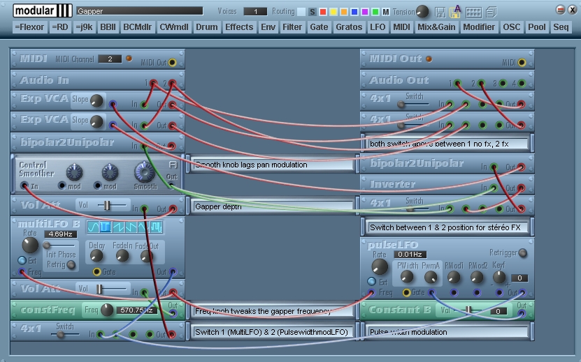

I'm trying to do the gapper with the modular... The thing I've done is almost what I wished. But I'm not very experimented with the modular. I know that you have much more experience thant me with it. I'm looking for a module wich could smooth a square LFO signal, something you may adjust the time for the signal to reach min to max and max to min value with the square LFO at the input... Do you know this module ? I'm pretty sure it's in the modular...

I've found it ! It's simply the Flexor 1.5 control smoother...

I made this...
It is something like an autopan with more settings...
I made it before modIV...
I put some text bars to explain the mainly settings to play with it.
It is really basic ! But usefull for playing with pan.
Flexor 1.5 is needed, I didn't find any native smooth module.
