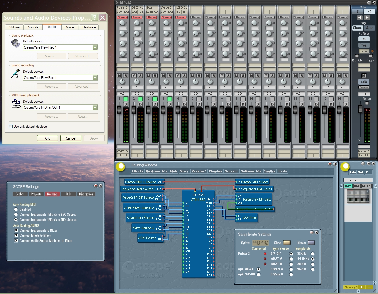

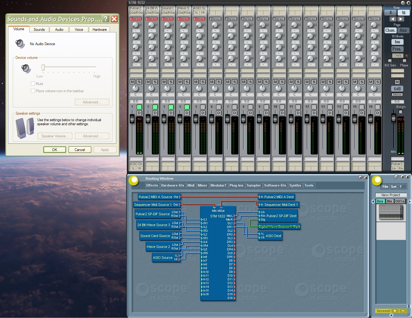

Here's how my setup runs now. I also included images. Mytek AD clocks Pulsar 2 through SPIDF then goes out SPIDF into Mytek DA. I use Normal Mode with Live Bar running, when playing games or listening to music. I use XTC within FL, but to use XTC I have to exit Live Bar. What I don't understand is that even with included wave modules I still can't use Pulsar 2 as a Direct Sound device. Also, when I use XTC mode plugins inside FL they sound all messed up, like really bad digital distortion.
SETUP PICTURE 1
SETUP PICTURE 1
SETUP PICTURE 2
SETUP PICTURE 2

First off, I see no Wave Dest modules in your screenshots. Fill up your project with either Wave Src/Dest or Wave 24bit Src/Dest modules as set in Device Manager > Scope drivers. Do the same for Seq Midi Src/Dest modules. Then try again.

and where's wave source(and dest) number 1?

Exactly.. I Think you should delete your in outs and start again and use the number 1 wave source/ destinations.

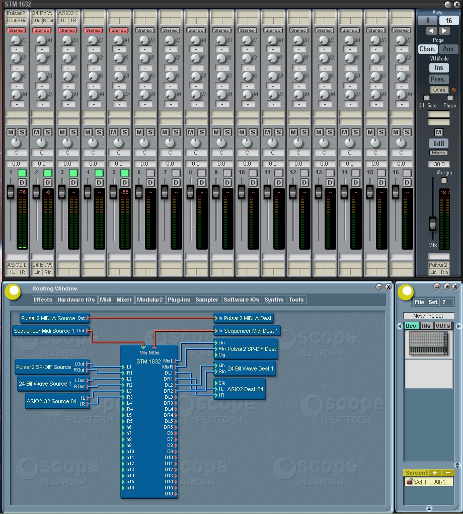

Post by quantum »
WOW, that was really easy. I just reinstalled Scope 4.0 back into Professional Mode and added the modules below. Windows XP still doesn't show a Direct Sound device under Sounds and Audio Devices, BUT I can control the volume via master fader now and all programs that use direct sound work flawlessly. Here's the image of my final setup:
