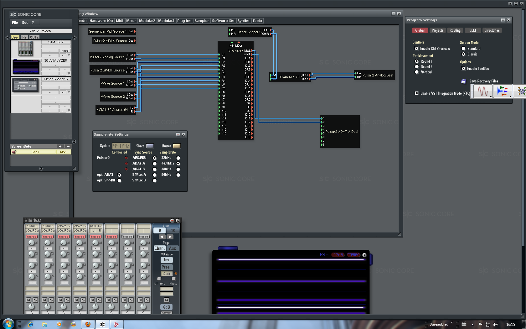

Hi folks,
I use A pulsar 2 card since manay years and used all that time the analogue output othat card.
Now I try to use the ADAT out, but the only sound I heard is noise.
In the attachment you see my connections.
Make I a mistake ?
Who could help me.
Steven

Re: scope 5.1 and ADAT out SOLVED
Post by Excellent »
Shame, have seen in other threads that in this case I have to use SPDIF out and in the settings opt SPDIF. Now it works. :wink:
Steven
Posts: 23395
if the device you are connecting to has ADAT i/o, you can use that. if the device is optical SP/DIF, then you must use that. looking at you screenshot, there's nothing attached to the card's adat ports, and if there is, then it's not connected correctly. the red "led" by the aday port name on the samplerate window should be lit if something is connected properly.
