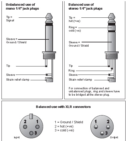

either way, the connector doesn't matter. what DOES matter is the LEVEL and whether or not the signal is BALANCED or UNBALANCED.
for the most part, if the mic pre is balanced out with an xlr connector, pin 2 will be hot, pin 3 will be ground and pin 1 will be shield(there's no standard, but convention seems to follow this rule these days). if that's the case, most adaptors will connect pins 1 & 3 together and pin 2 will go to the tip of the rca or 1/4" connector and all is groovy EXCEPT if that xlr output is +4(which is normal for xlr balanced line level). in that case, you will need to lower the output level significantly in the pre in order to avoid clipping, as unbalanced connections are generally -10 or -20.
in the rare case that the xlr out is pin 3 hot, the when shield and hot come together, they short and you get no sound or low, distorted sound. in that case, you'll need to wire an adaptor cable, rewire the connector on the mic pre or use an pin2 to pin3 xlr adaptor.

Be aware that 3 DSP board usually haven't got balanced input. 1/4 TRS is 2 channels: tip=>hot ch1, ring=>hot ch2, sleeve=>ground.

Cochise wrote:Be aware that 3 DSP board usually haven't got balanced input. 1/4 TRS is 2 channels: tip=>hot ch1, ring=>hot ch2, sleeve=>ground.

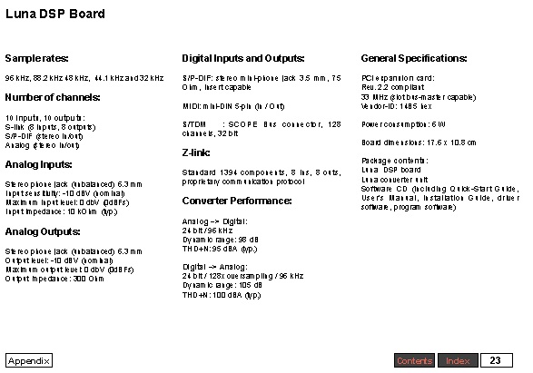

I couldn't find any info regarding SCOPE 3 DSP card I/O input type on sonic-core.de? If input is unbalanced isn't then easier to use 1/4 jack from mic preamp? But my mic preamp have balanced output.
In other words - I should use UNBALANCED 1/4 cable to connect my mic preamp to SCOPE 3 DSP card analog in?
Confused... !??
Cochise
Posts: 1305
Re: Mic connection: to Scope card or to Luna 2496 I/O interf
Post by Cochise »
You can find specs in the manual (appendix)
Luna specs.jpg (72.31 KiB) Viewed 3091 times
You need a balanced to unbalanced cable. My advice is XLR to RCA, using the 8 I/O external unit (Lunabox). The cold line from the balanced out has to be grounded.

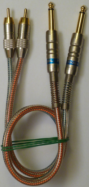

Or you might use an insert cable (1/4 TRS [stereo] at one end, two 1/4 TS [mono] at the other). The stereo jack goes at the Luna input, one of the mono goes at the pre TRS output...
Or a 1/4 TS (mono) to RCA from the pre to the Luna box.
If you set your mic-pre close to the Lunabox you can even use very short cables, which is good for analog signals, especially with unbalanced lines.
