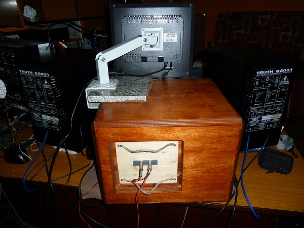

Just had a look at this unusual project... it's called 'the door'...

I've forgotten... this is the subwoofer
I didn't get the dedicated amp yet, so no hardware phase nor freq controls...

I eventually succeeded in fitting the sub on the desk
I'm testing with external amp.
The sound is really deeper now (I'm filtering around 50 Hz)
One thing I didn't expect is the electrical signal at the sub speaker being almost 180 out of phase with the signal microphoned at B2031 woofer (50-60Hz measurements); the signals instead are almost phase aligned when I put the stock Scope low pass filter in the output chain to the subwoofer.
I'm wondering if I'm messing with bass reflex polarities and/or mic positioning

If that LCD is ccfl backlit the current mounting (to a vibrating subwoofer) is going to severely shorten its lifespan. Thought I'd warn you so you can prevent turning it on someday only to find it dark.

Thx for the info. I might try to put some damping material (a diver wet suit?) under the marble block where the arm is fixed... though those frequencies are hard to damp.
Then other troubles could happen with the other LCD staying in front of the subwoofer, under the visible one...

Ok. The "deepness" was due to 180 degrees phase difference.
I repeated the test using a single mic alternatively for the two signal lines and a control signal. Then I added an inverter in Modular environment. I had to lower the cutoff to 37 Hz.
...The inverted phase sound at 50 Hz was strangely nice though...
The phase measurements features in Visual Analyzer has got a threshold control I didn't noticed yesterday, and the average has to be set to 1

Is it completely 180 degrees out of phase? Many subs have a rotational control (rather than a switch) that helps you vary the phase...
As for the LCD, damping won't help as the arm is a resonator unfortunately. I know how you feel about LCD clearance issues though, I've still got my rightmost monitor sitting on a cutting board (wooden bread board) that's been sitting on this X-stand for far too long. I've been planning on getting some longer monitor arms (like those made by Ergotron) for far too long...
