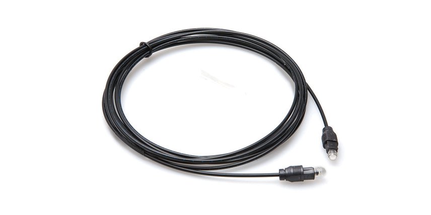

regular old hosa cheapies.
they're still being used in a professional studio.
actually, expensive, fancy optical cables often won't work well because the ends are too bulky and they don't fit in the sockets in space on the card well(too big, too close together).

there are repeaters for long runs. technically, 10meters is supposed to be the maximum, so if you really want to be safe, go with that or use a repeater(amplifier) for longer. just sayin'....i have used 50 footers and they have worked(50ft=15m).
