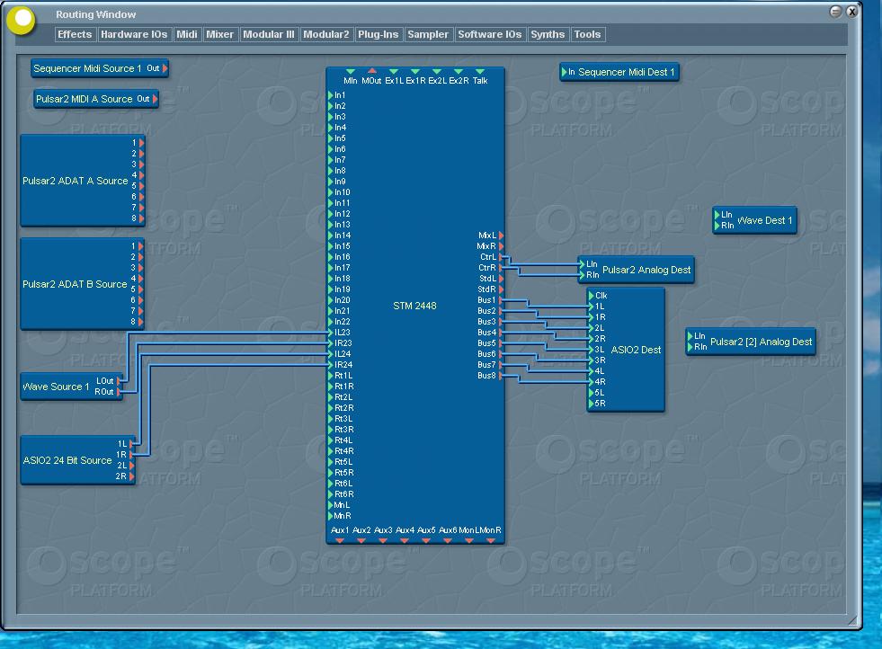

post a screenshot of the sam audio settings and your Scope project.

My routing window is
pulsar 2 adat A and B source to asio 24 dest,total 16 tracks
also have a wave source stereo and asio source stereo to a den mixer and then to wave dest and pulsar 2 analog dest.

Yep that helps,Had a long chat with Gary B and all is well.I even got Samplitude working again.Its not done yet but here is my routing window so far.Well i thought i could post the screen shot,i have it on a flash drive but the forum says the extension bmp is not allowed.

Re: Lost audio in and out
Looks like it worked this time
- here ya go
- Scope.JPG (91.6 KiB) Viewed 1054 times
