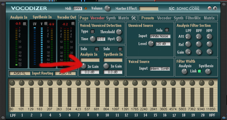

Hi all!
found an annoying bug in Vocodizer (scope 5.0.2617). When loading a project with Vocodizer audio input connected to ASIO (probably to any source), no audio arrives at the Vocodizer until removing and reloading it. Does anyone know this problem and is there a fix or workaround?
Thanks in advance!

don't know if it has already been solved, just in case, my workaround is to double click(or just move) the "analysis in" pot, then save the project and it will work after reopening the project.
I have also uploaded a modified version of vocodizer that works at the following post:
http://forums.planetz.com/viewtopic.php?f=1&t=31088
