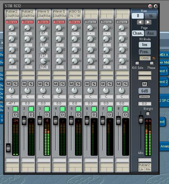

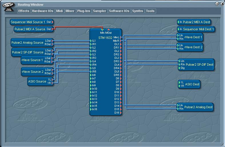

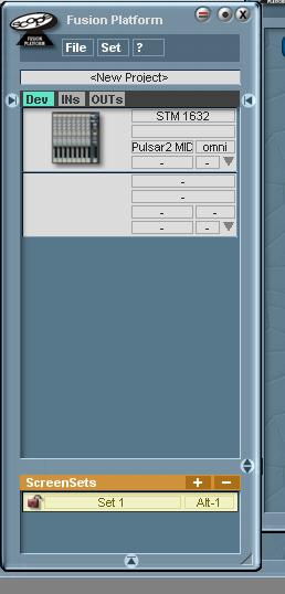

Re: Everything works. not hearing anything
Can you post a screenshot of your Scope project ?
sure,
not being sure what the project means, ill post anythnig

the mixer looks OK?
what else can it be?

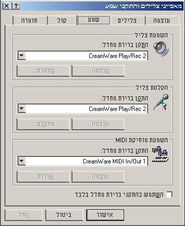

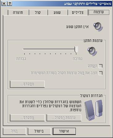

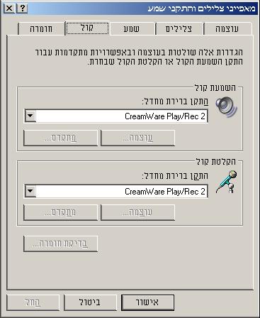

checked whip connection to the card... seems fine... checked amp... seems fine.
i saw one pecuiliar thing.
im attaching my sound devices menu from the win xp control panel
its partially in hebrew so i'll translate the important and strange stuff
this is the strange part. see that i cant control the gain level? above the slider it says: "no Audio Device"
in the next pictures the audio and sound tabs show me i can choose to output the sound to pulsar source 1 and 2.
its now on 2 because i tried to check if it made it better. but the thing with "no Audio DevicE" is strange to me. is it suppose to be this way?
no, that is proper.
Scope is external, as far as the computer is concerned. the audio is calculated on the dsps, not the cpu. a Scope card is not a standard windows soundcard. windows has no idea what is happening in regards to audio. when a Scope card is used.
if you see level in the mixer, there IS audio there, period.

Why is your mixer routing showing Pulsar IN? Shouldn't it be seeing Analog out?
Seems like you have some (internal) wires crossed

the edirol is a soundcard on another computer. i wanted to give pulsar its own machine (an old one, to match). so its my external amp... and i checked it (volume, connectivity, everything)
but Greg said something interesting.
i was wondering about it too.
Gary said the wiring was fine but i was wondering why the mixed bus channel (dunno if thats the official name), the right most channel, was routed to pulsar R-in L-in. isnt that suppose to be R-out L-out?
wiring problem matches all of the symptoms... could it be?
No, it's correct as it is. You are wiring the outputs of the mixer to the inputs of the module. That module just happens to be your analogue output but could be anything. Anyways, you can't wire outputs to outputs, Scope won't let you (although it does allow inputs to inputs - I just tried to confirm).zoharar wrote: but Greg said something interesting.
