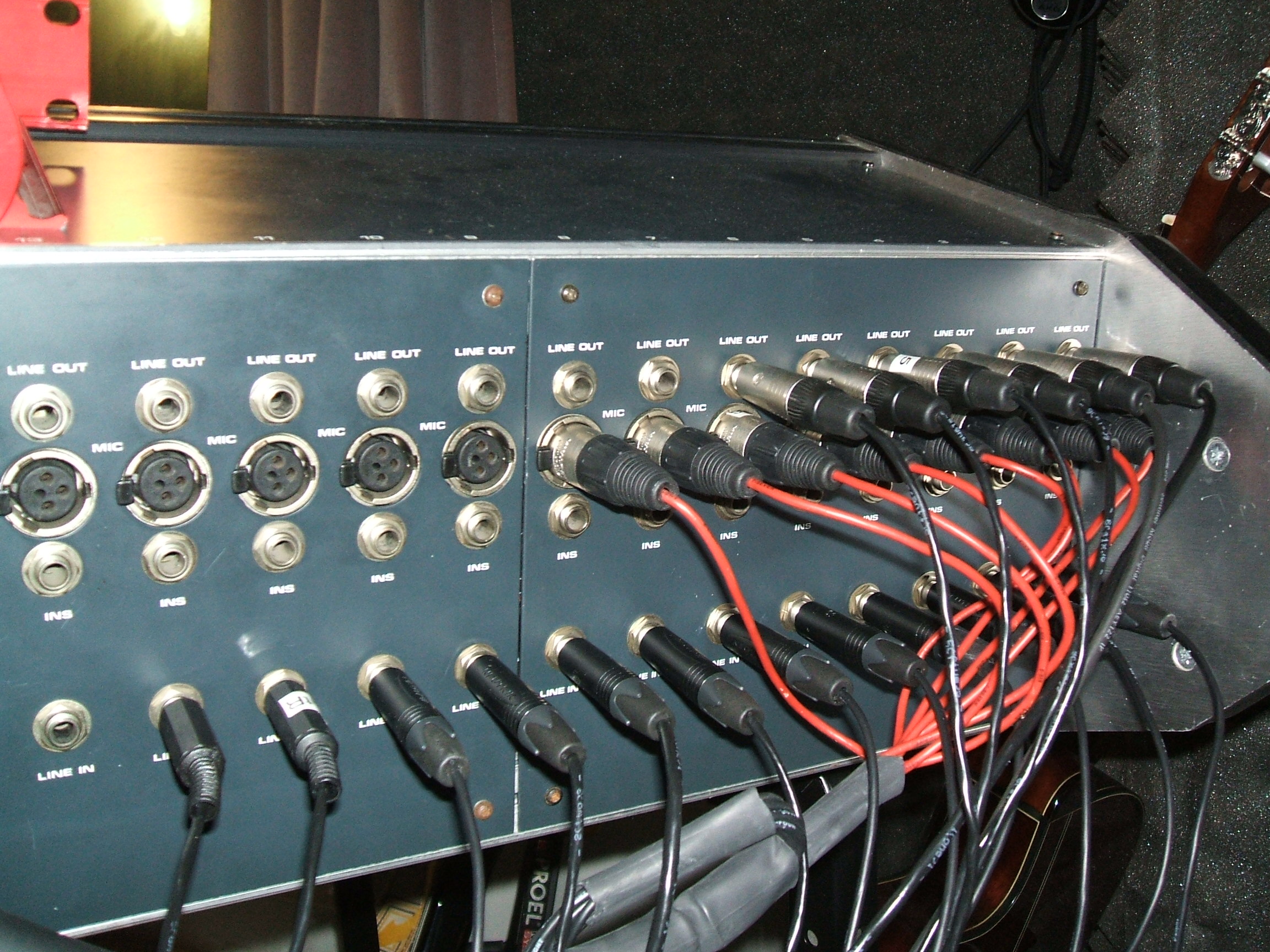

Hi, I have a problem of scope. I can not handle channels with pan.
left. right.
What might be?

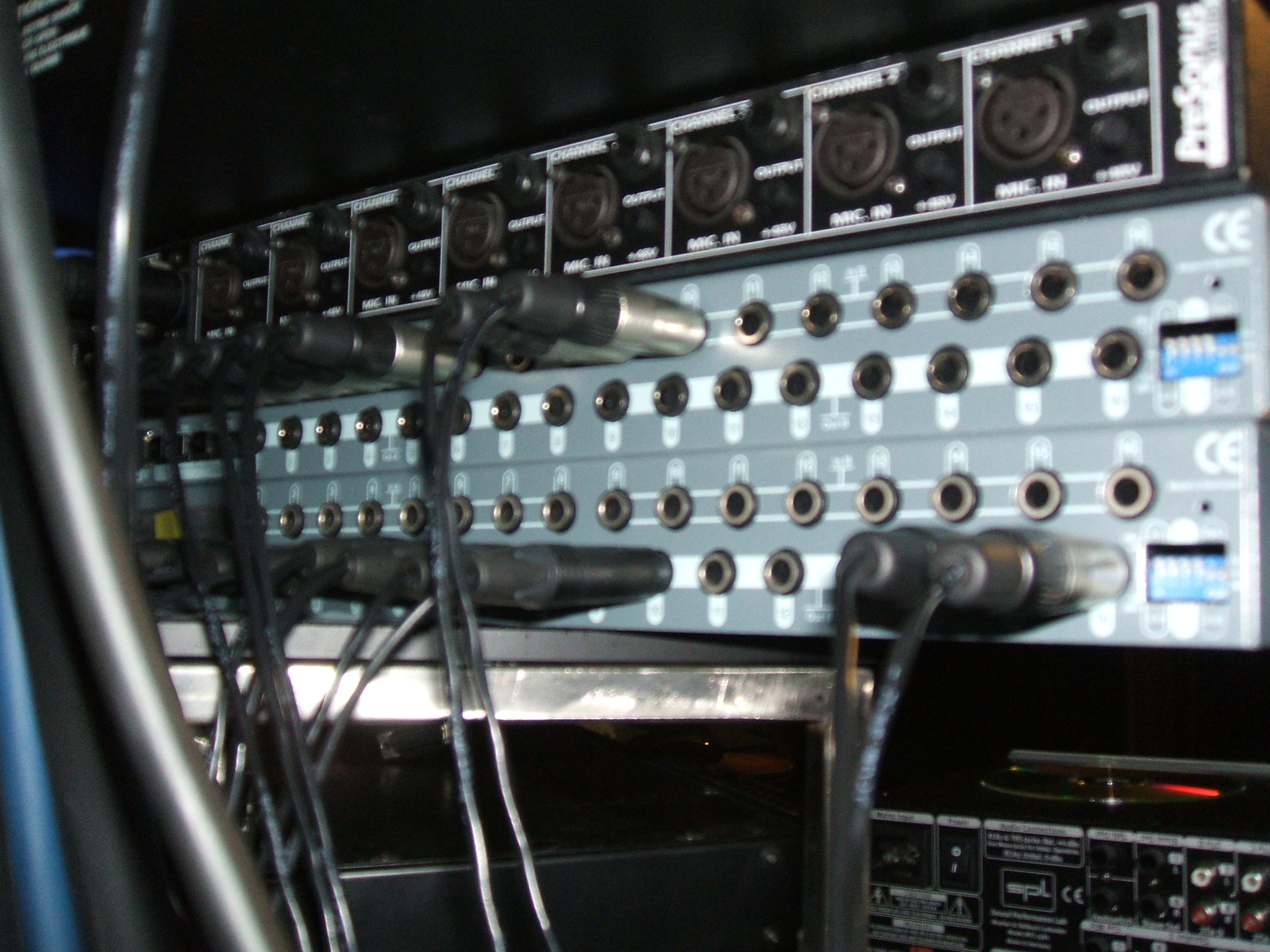

Are you saying that when you turn a pan control in your scope project, the sound is still center on your monitors ?
What are you connecting with your z-link ?
Have you eliminated your monitoring setup by monitoring something else ( eg iPod ) to see if that pans, or that the music from it plays in stereo ?

yes the problem in the soundcraft control room .
i put mic rec on direct out into zlink in and record then i out zlink for master on soundcraft.
but no run pan pot of the mixer , i think.
soundcraft custum 600 ( 16 chanel more 8 bus)
i don't know .

So you go from Soundcraft->Zlink->Scope->Zlink->Soundcraft ?
And then theres no pan on Soundcraft ?
What happens if you bypass Scope eg Soundcraft->Zlink-> ->Zlink->Soundcraft ?
Is there still no pan ?

Line Out is pre-panpot but post-fader on the Soundcraft 600
