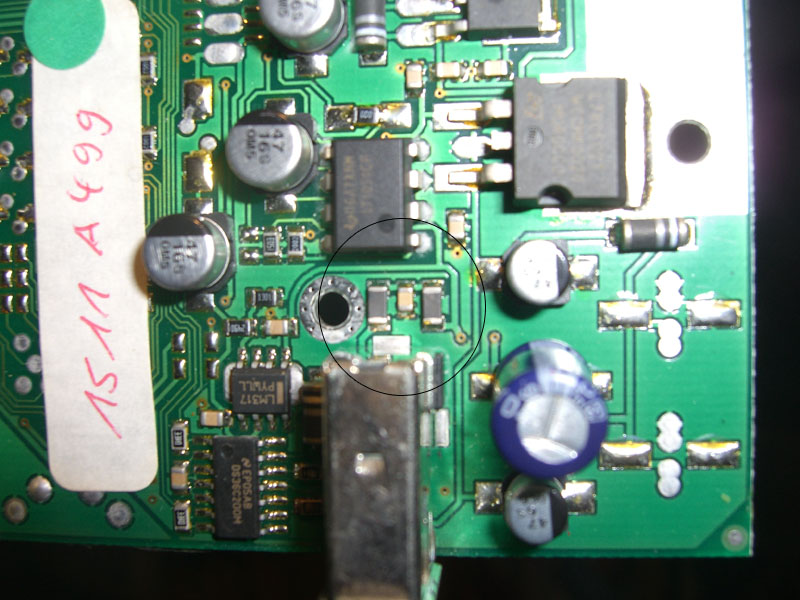

Thanks a lot for your help. I've attached a picture of the components next to the fw port - would the encircled thingys be fuses?

jhulk
Posts: 935
Re: Have I killed my 2496 i/o Box??
Post by jhulk »
no there ferrite beads
theirs one right by the side of it not the back of it

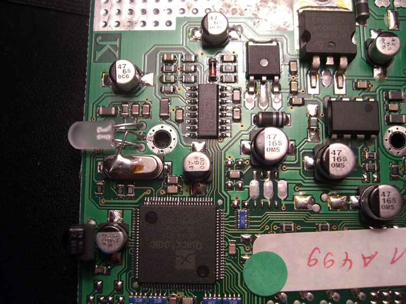

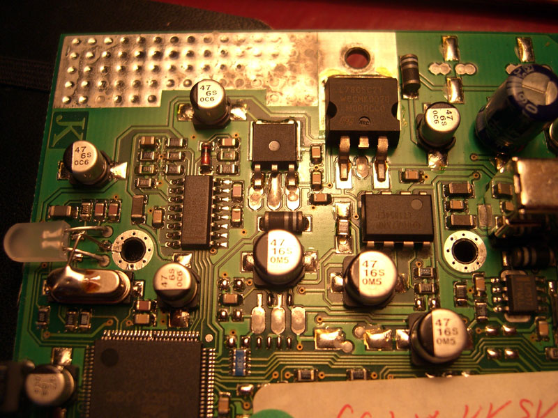

the lm317 is a power regulator
jhulk
Posts: 935
Post by jhulk »
its a linear ldo it has voltage in and then a regulated voltage out
check the positive led and trace back to the connector there should be a inline fuse smaller than those ferrite beads
jhulk
Posts: 935
Post by jhulk »
once you trace that leg if you find a inline fuse use a continuity tester available on all small ac/dc digital meters it has a bell if its blown you wont get the bell sound if its ok you will

Jhulk, I'm afraid this is beyond me ... I'll post two more pics, maybe you can point me towards something fusey. I can solder and desolder components, but that's it.
Btw, I noticed the whole section in the pics gets warm when plugged in, even though nothing else happens.
Has noone else ever had the "connected" light flashing in the Samplerate window?
The fw connector with the two ferrite beads is on the right
