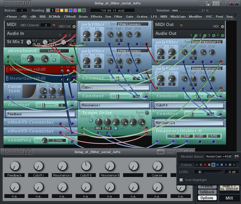

Hi..
I made this stereo delay with 2 serial filters (poly filter) in the feedback path cause I wanted to obtain some special dub delay. As the result is not bad, I suggest you to have a try.
I used only text bar from Flexor, all other modules are avaible.
Have fun..
Delay_st_2filter_serial_JoPo.rar
(524.84 KiB) Downloaded 669 times

I'm wondering if a delay like this one uses more dsp than the same one made up in a SDK device..
Does anyone have this information ?

Post by w_ellis »
You could definitely optimise DSP utilisation if you built it using the SDK by only including the features you want to use. However if you built something identical, it would have very similar DSP load (or at least that's my understanding!).

Thanks for the fast answer !
It's what I 'believe' too, I'd like to be sure !
I allways hesitate to build a small modular fx (for filters, for example) in the modular2 insert shell because of large dsp use anxious.

Re: Stereo filter (dub) delay
Post by w_ellis »
I guess it depends on how much DSP you have and how frequently you use the given FX. If it's something you use all the time, then it would be worth the overhead of building in the SDK (i.e. putting together a custom interface etc.)
