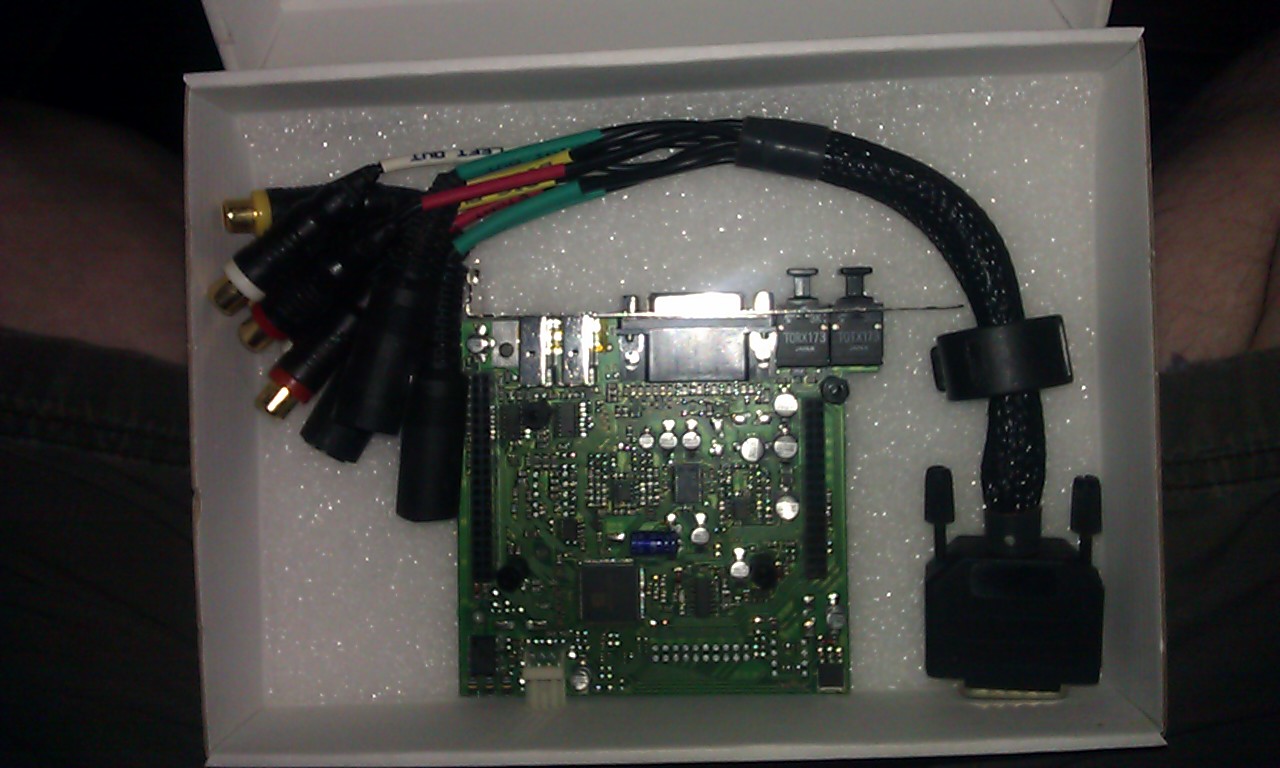

I actually have one of those plates I don't need. I started with a "normal" one then bought the plate when I got an A-16Ultra but I'm using Apogee these days so I no longer need it. I tried to sell it on eBay a couple times but never sold it. Think the market for those is pretty specific. I'd sell it for $100. I paid $189 originally from infinitevortex.com, fraid they're not around any more . Just not sure how to go about shipping it to the Netherlands. Let me know if you are interested and we'll work out how to make that happen.

if you're in the USA, USPS priority mail works very well. you'd need to fill out a short form declaring that it's computer parts and worth $100 and insure it. it's not that expensive. he can pay you through paypal.

Thanks for the info. Sounds like it's not a big deal. Attaching pictures of what I have. It's available if interested. I'll probably post it on the sale part of the forum in a few days if I don't hear anything.

- Zlink box.jpg (411.65 KiB) Viewed 2889 times
- Zlink Plate.jpg (401.89 KiB) Viewed 2889 times
"The computer can't tell you the emotional story. It can give you the exact mathematical design, but what's missing is the eyebrows." - Zappa
