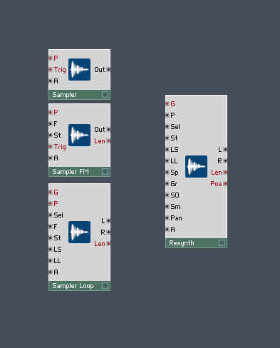

and now I remember why I didn't bother to check the rest of the reaktor samplers for audio rate start time inputs:
>>control rate sampler gate/trigger inputs!!
a nogo for my tasks, check demo, kindergarden it is indeed.
still, once I tried to get the effect supplied within the demo, with reaktor, and it sounded just horribly thin, maybe some interpolation going wrong, and maybe because of the max 3200hz polling rate for the gate to audio conversion I had to apply, if I remember correctly
don't try to tell me reaktor is not a toy, but I have to admit it is a quite stable reliable average toy for the everyday musician, just like a volkswagen, right? gets the job done, but does not excel getting it done, nor does it shine.
but then, how can it compete with a dsp engine that does 56 bit integer processing on all of its internal tasks? (h4000-h8000range eves)
your response sounded like you were offended by me calling reaktor kindergarden, I'm sorry but in such a case I have to add fuel to the fire
but then, if NI should read this, maybe they update some modules to really use today´s CPU power adequately, meaning updating all internal signal paths to full resolution audio. too much asked? got to have to stick with dedicated dsps then.
and as I said, there is only kyma and to some extent eventides that can get the job done really well and excel at it. but I am not sure about the kyma cause I never had one, probably a mistake.
and still I think the scope environment with all its sufficient dsps would be ideal for really crazy real time triggerable audio resolution sample madness...too bad there were only the - admittetly magnificent sounding - STS samplers, and maybe some modular modules, like sample oscillator, but they were very limited and if I remember correctly, they also just had gate trigger inputs...lolz-..
