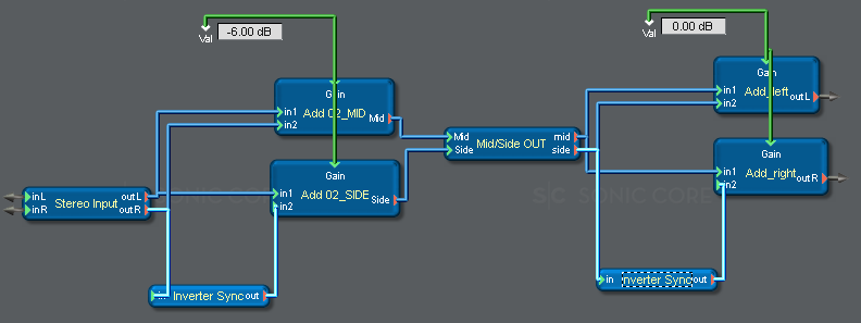

fra77 m-s module allowed me to understand why stereo field is altered with m/s devices !
Put fra77's module at the output of a ping pong delay, just put an amp gain on 'm' and another one on 's'. You think, hum... At least i (me, poor half-witted) thought I was going to increase the stereo field feeling by adding gain on 's' ... Have a try ! The field becomes thinner. Because additions & substractions need to keep the same value to rebuild the signal correctly, I guess. Thus it's quiet normal that by changing gain frequency (like in an eq) only on side or only mid, the stereo data are lost... Am I right ?
I'm realizing that in fact, it's very difficult to process mid & side in different way and get a nice stereo result ! I think that to keep the stereo image in a m/s device, some much more complicated processing is needed !! Brainworx BX, for instance, must have much more processing things than a simple m/s device like fra77 one's and a simple eq for mid signal & another one for side... And the stereo placement is drastically affected anyway.

:) Brilliant, RA ! Thanks for explaination. That's what I undestood by experimenting with fra77 ms device. And I guessed it's a phase / latency problem which gave me this bad result. But you put math on what was just an intuition for me.
So what do you think about this way to do (mainly how L/R mix is build back) ?
I don't see any M+S/2 function to build back the stereo signal...But gain function is the same, isn't it ? And also, how would you advice me to check phase - latency in each part of processing ? I must tell you that I don't use SDK, if I try to make some "personnal" m-s processing, it's only with Modular or Scope -> with mathematical BCmodular or CWmodular modules, it's already possible but as you explained, I need to mesure / control perfectly latency everywhere to get a satisfactory result...
Thanks a lot !

The m-s jpg was given to me by someone here some years ago but I cant remember who.... I thank him anyway ! :D
