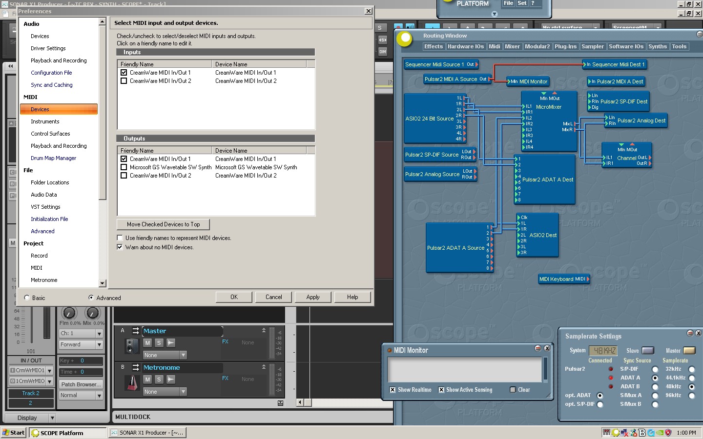

i want to play scope synth from another pc so i connect "IconnectivityMidi4+" din midi out to pulsar midi in. but not getting any midi data :( the midi out is working fine (if i connect a usb keyboard and select it from DAW and midi out to another pc/keyboard) plus rest of the pulsar2 fx/io is working great.
pulsar2 MIDI A source out: is the midi in... Right? ... maybe something silly mistake im doing :(
can anyone guess what could be the problem?

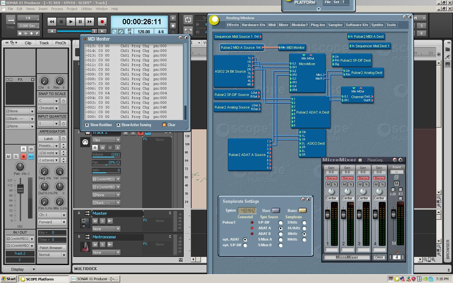

whatever i do (note on/of, pitch change, modulation change... ) all it receive program change message!
please see the pic.
prog change.JPG (238.43 KiB) Viewed 3311 times

That seems a bit strange. It looks like midi is working but maybe there is a setting on the hardware that is outputting midi that is ony allowing program change. At least there is some signal. Also is the Pulsar 2 cable whip still in good condition or colud that be causing some problem Two things to try next then.
1. Try using another midi hardware to output midi signal, for example do you have a simple midi keyboard that you can connect directly to the Pulsar 2 midi in.
2.Check the actual midi cable or try using another cable just to check if the same thing is happening.
Posts: 23395
Re: pulsar 2 midi in not working
yeah, i would say that the problem is in the unit sending midi to the card. it's obvious that midi is working.
