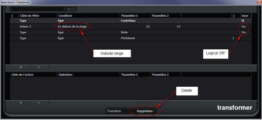

Since now, if I add 'send to' Scope in a Cubase vst instrument midi track to control the sound of this vsti in scope and have the controler track editing in the same midi track, I place the 'transformer' Cubase midi fx on the send to keep only midi data really needed for the Scope sound control.
Like this, it's upstream, as Shark recommended : I filter midi data before it reach Scope and I can notice that Scope is very happy to receive as less midi data as possible.
BUT (info for Cubase 8 users) : when you add a logical 'or' in the transformer, you must save the preset, close it and reload it again with the preset to have it working ! A Transformer bug which I took time to find ! :x
In this example (sorry in french) , I let go to Scope only controler 12 & 13, no note and no pitchbend data.
