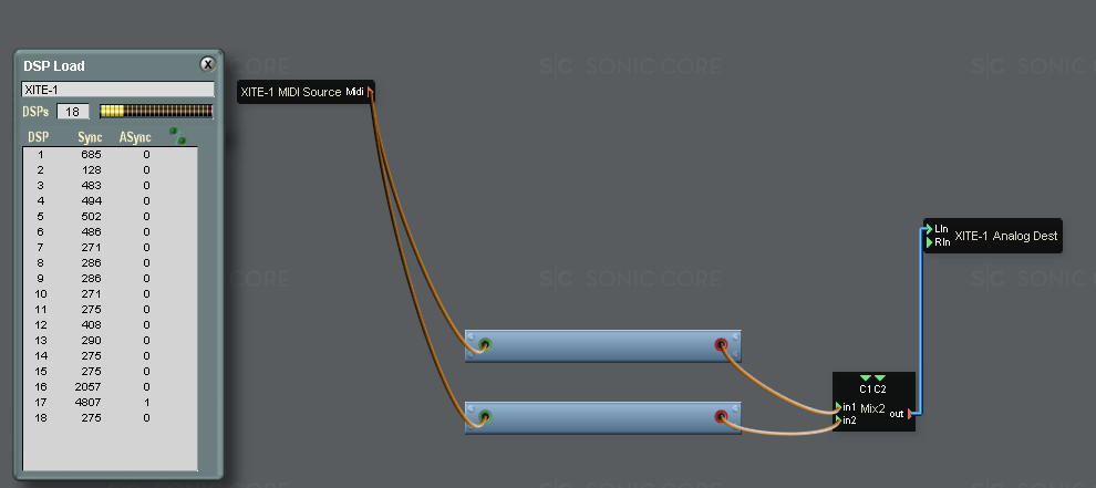

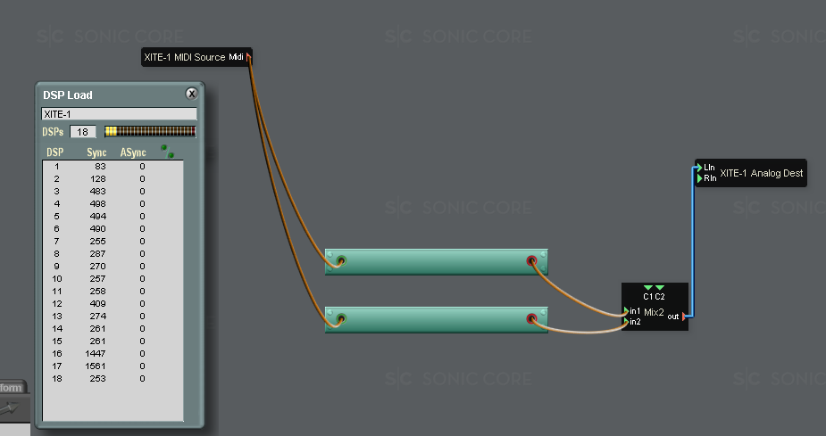

I'm trying to go from mono- to polyphony. I'm encountering - as expected - a lot of problems (i.e. DSP overload). But something seems to be wrong:
I've split my module into 2 modules having 16 partials each. In mono-mode, the load looks normal/balanced:
In polymode (2 voices, 1 module is assigned to DSP 16 the other to 17), the load looks unbalanced:
Any idea, how to solve this? In this situation, no sound can be produced. DSP seems to bead locked.

Somehow, the problem solved itself. Load is now 4000 on both DSPs without the infamous sat connection error.
