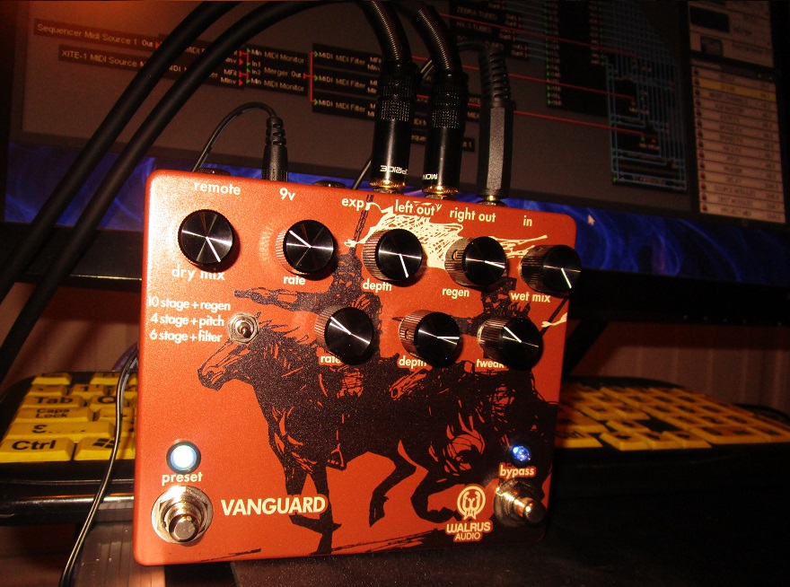

It only took 10 years of using Scope but here is the way to bring the Phaser of Death in and out of Scope.
Load up the module below.
Drag a Master Effects Module from the Tools Folder into it's inset slot.
Connect wherever you want, but I use an AUX from a mixer so every channel has the Phaser of Death.
Tried Scope Phasers, too much dry signal in the sound, tried various pedals, Phaser 90, Small Stone, TC Helix,
but Walrus Audio is that old fat bastard sound from the 70s as it's an OTA.
I got 3 presets.
1) Phaser + Filter
2) Dual 10 Stage
3) Phaser w/ pitch shift
Then when I want the effect a fader attached to the Master Effects Output knob goes from clean to full tilt.
Any Channel with AUX 2 turned up gets juiced...
This is old school but so many EDM mixes I like that use Phasers could get a great jolt from this.
I also route it through the Radial Space Heater with 80% drive so it's a fat son of a bitch.
The trick and Tip is using the Master Effects Module volume knob inside of a MIDI Host.
