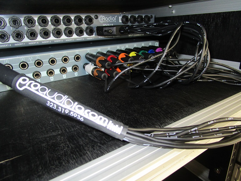

Here's my Z-Link B Source and Dest for 8 channels at the moment.
I can add another Z-Link from an ADA8200 or the Midas M32.
Right now just adding balls to these 1s and 0s is working out well.

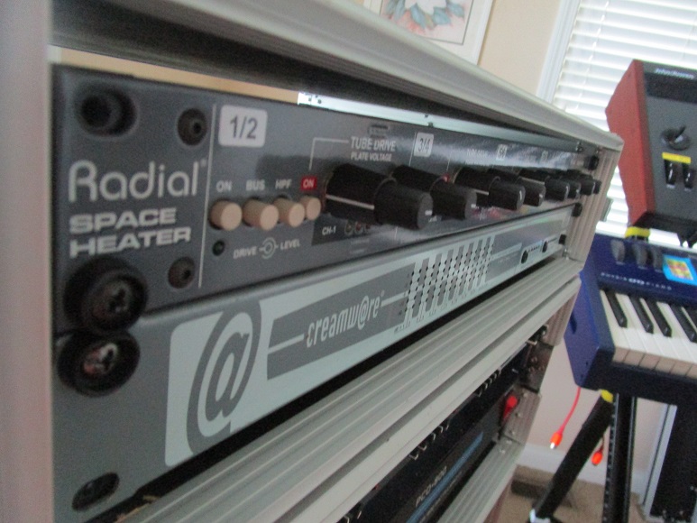

Taking ASIO signals out of Scope Project Window, adding Tube Grit, then send them back sounding better.
Always liked that overdriven Electric Piano Sound, etc.
