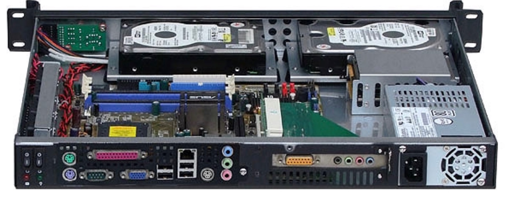

I like these open racks and side firing fans in my PC because I’m building a new AMD 3700X 1U PC.
1550 bucks @ 65 watts on the CPU so no worries on heat with these new 7nm chips.

I’m removing all Drive Cages since I’m only using a pair of 512GB M.2 NVMe Devices.
Don’t need no stinking SSDs.

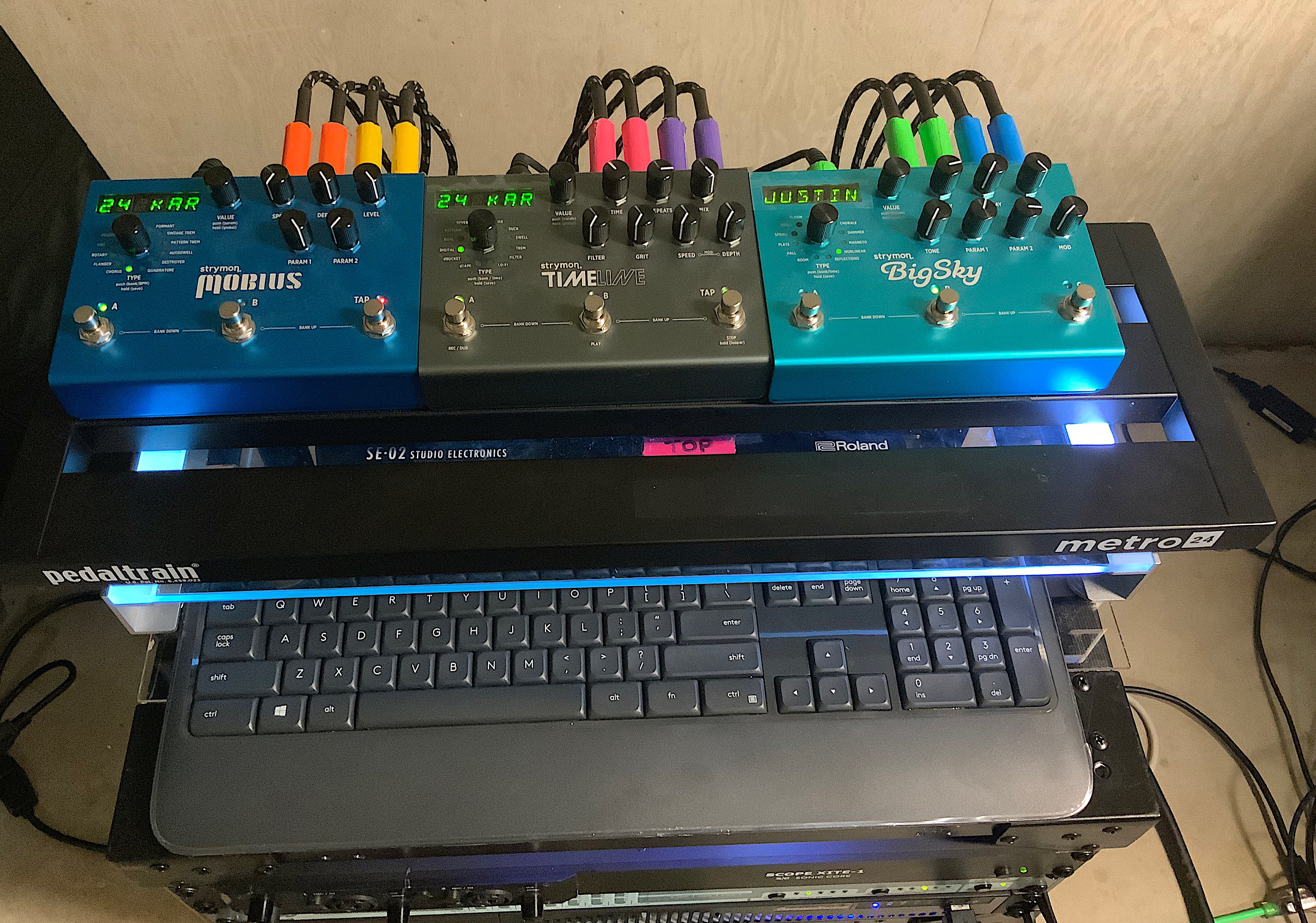

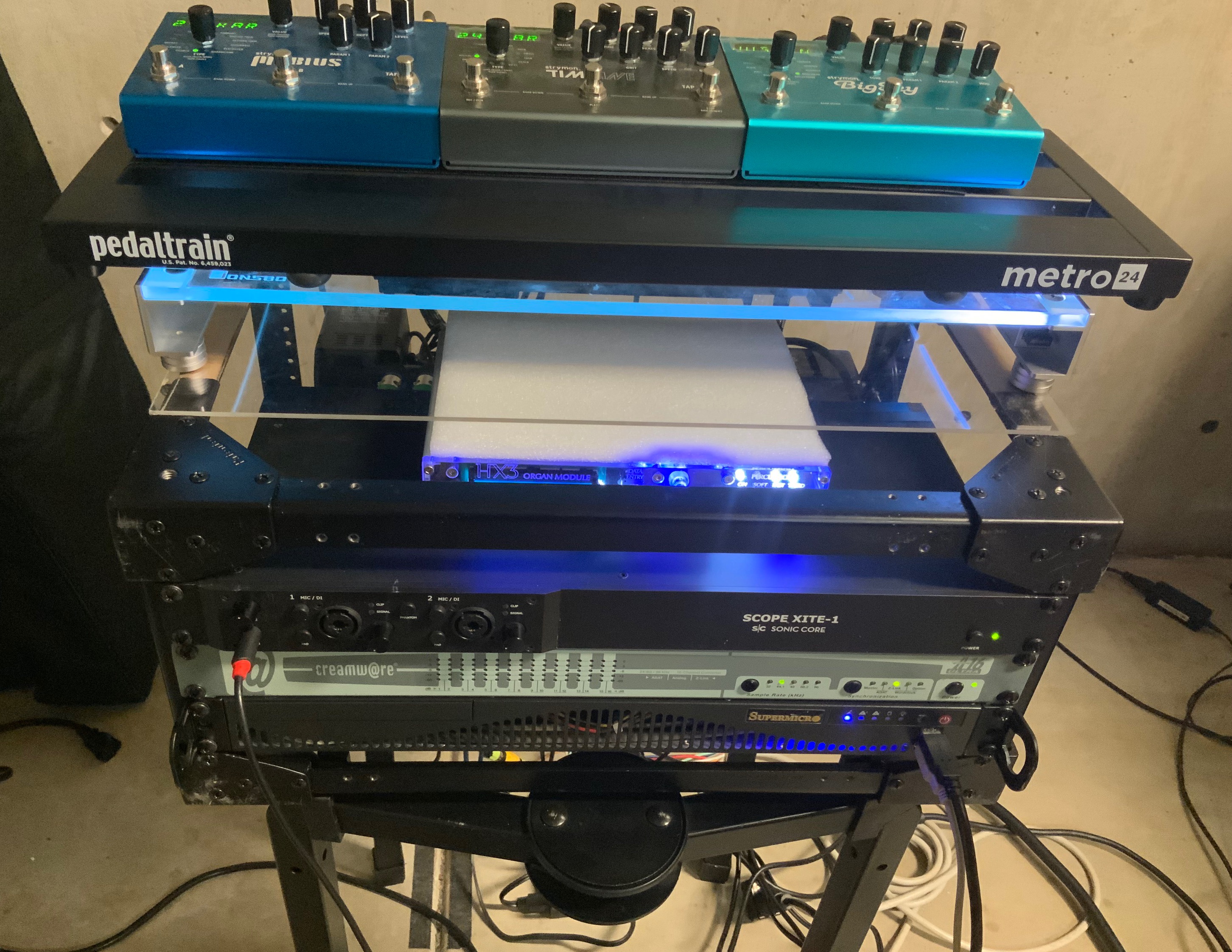

Re: HEAT - How much of a problem is it for the XITE?

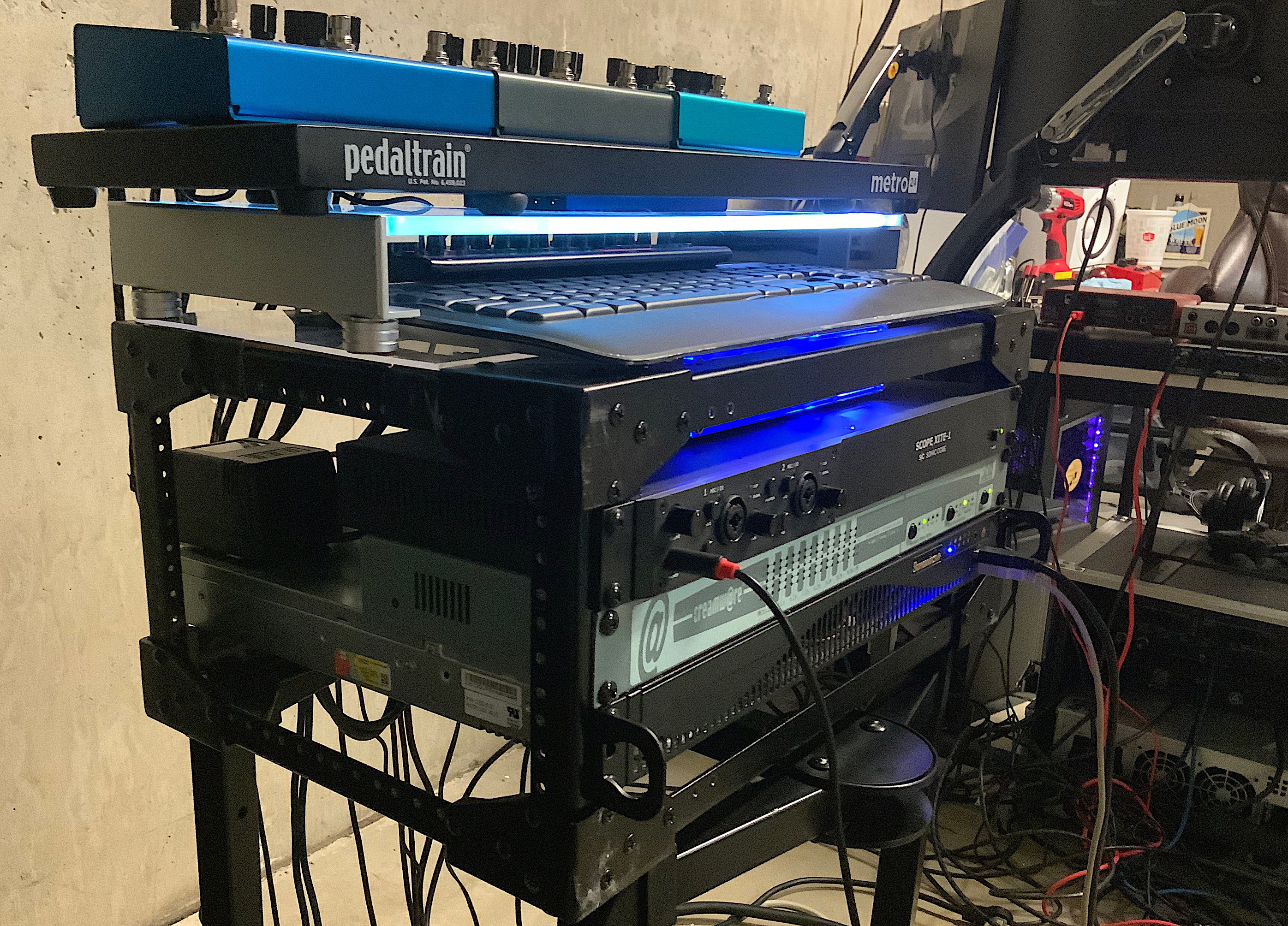

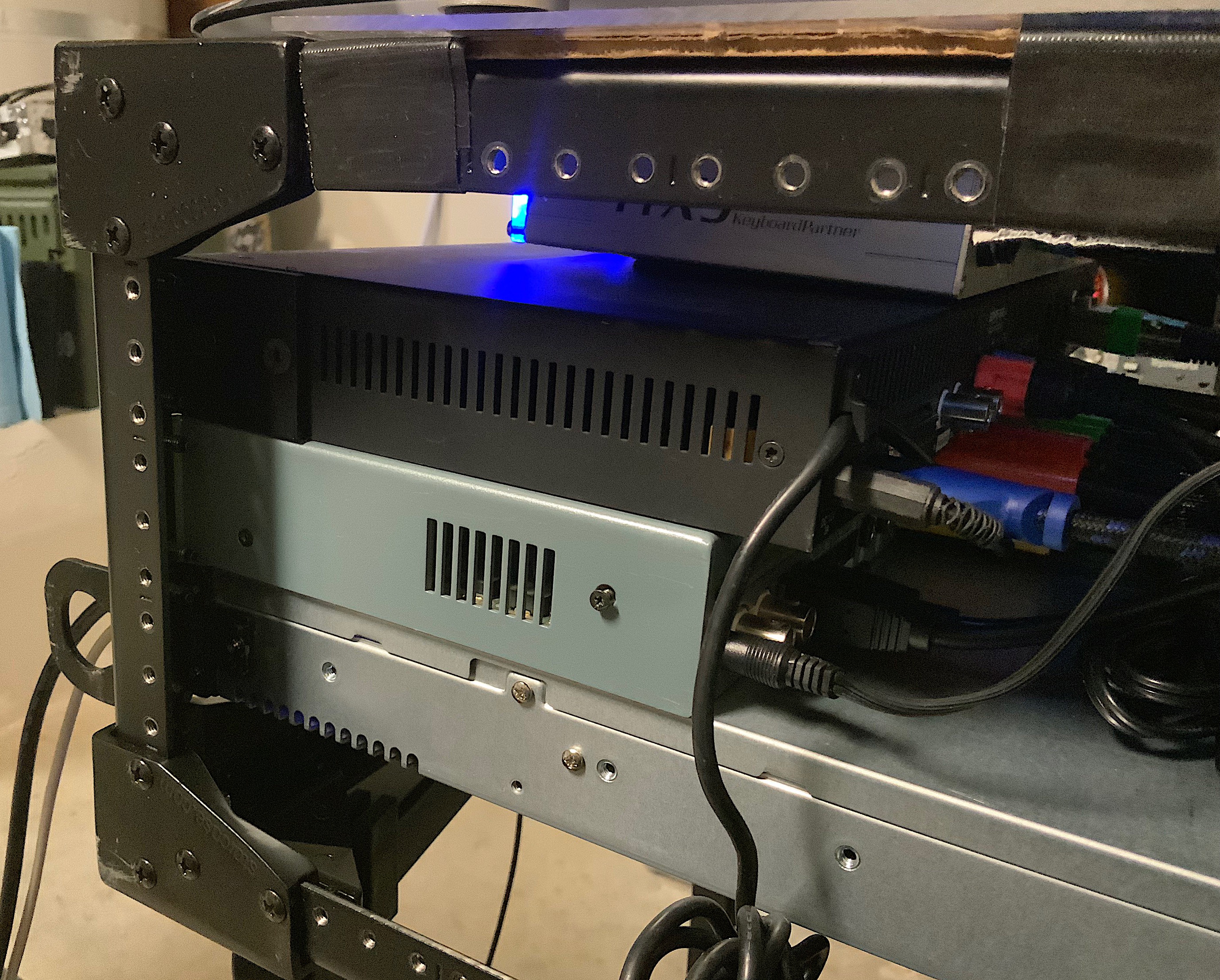

Here’s some views of the summertime rig.
These frames can also be shoved into shockmounted rack ATA 2” foam cases for flight.
Taken back out for local gigs.
This is the 13” deep 3U Model.
Nice setup there Jimmy. Looking good. Colour coded cables and all, no expense spared.

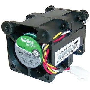

The side vents on S|C gear might benefit to have air blown across the main board and chips using one of these.
If heat is the problem one of these will fix that.
I’ve got these on my PCs and they’re so strong I can leave a piece of paper on the intake section of a 1U and it stays put instead of dropping.
