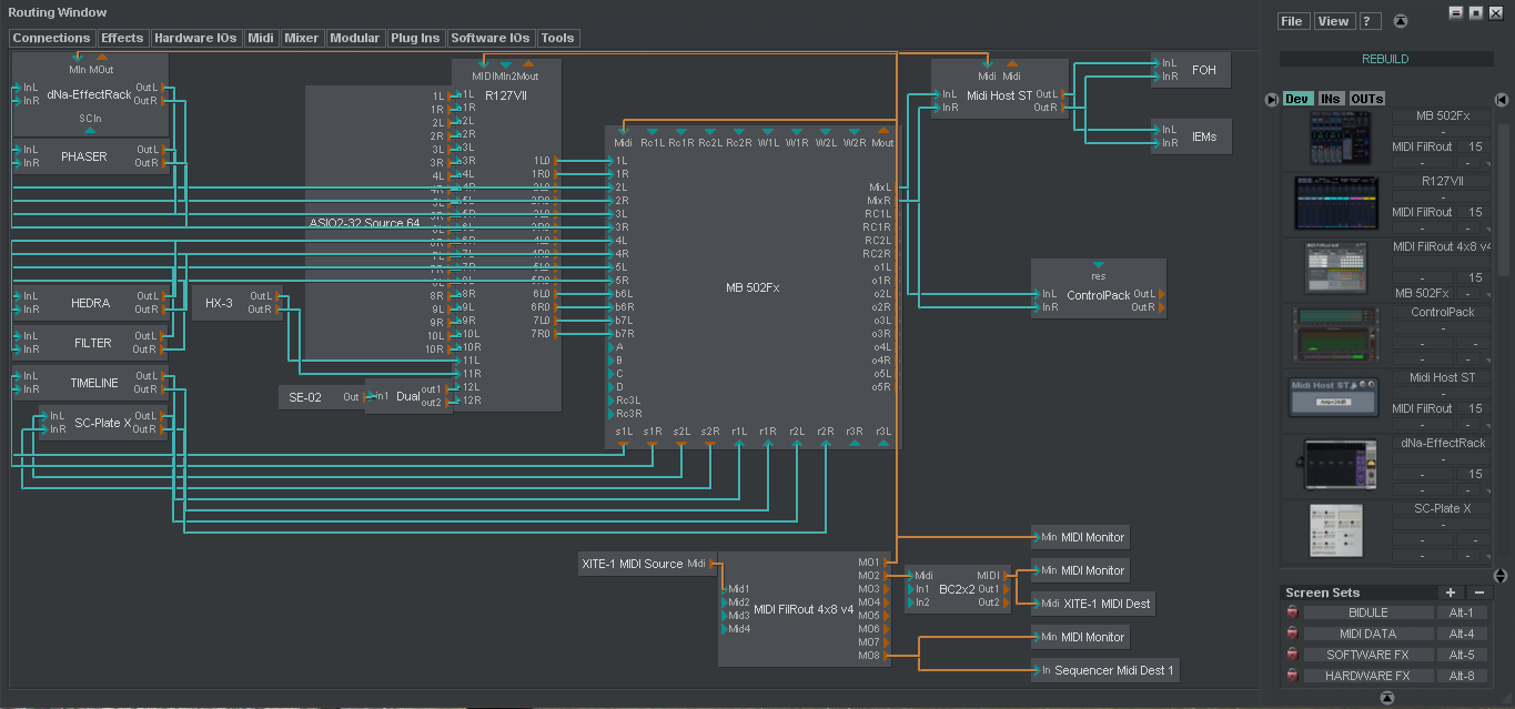

My aim is to have a single MIDI knob that, when I turn it, multiple things are adjusted in Modular.
Specifically, I want one knob to:
Attenuate gain
Boost gain of a low shelving parametric filter
...across two channels
I've been looking in Modular and I can't see a way to do it.
Anyone got a tip on how to do this?
https://imgur.com/W1PuJXk

Solved it!
Found I could use SpaceF's CC5 module so:
https://youtu.be/RBTuLUS1tec

Care to elaborate? As far as I could tell the knobs for the Vol Att and 12dB LowShelfEQ don't have control signal inputs so the only way I could think to do it was to "go outside" of Modular and pre-process the MIDI CC signals using CC5.

I have a similar module inside of modular for moving 16 Controls outside or inside of modular with lag processing to control the rate using curve modifiers for each of the 16controls.
I use it for Hammond B3 drawbars on my HX-3 Organ Module.
Lower right corner of project window.
BC2x2 > XITE-1 MIDI Out > HX-3 hardware module.
