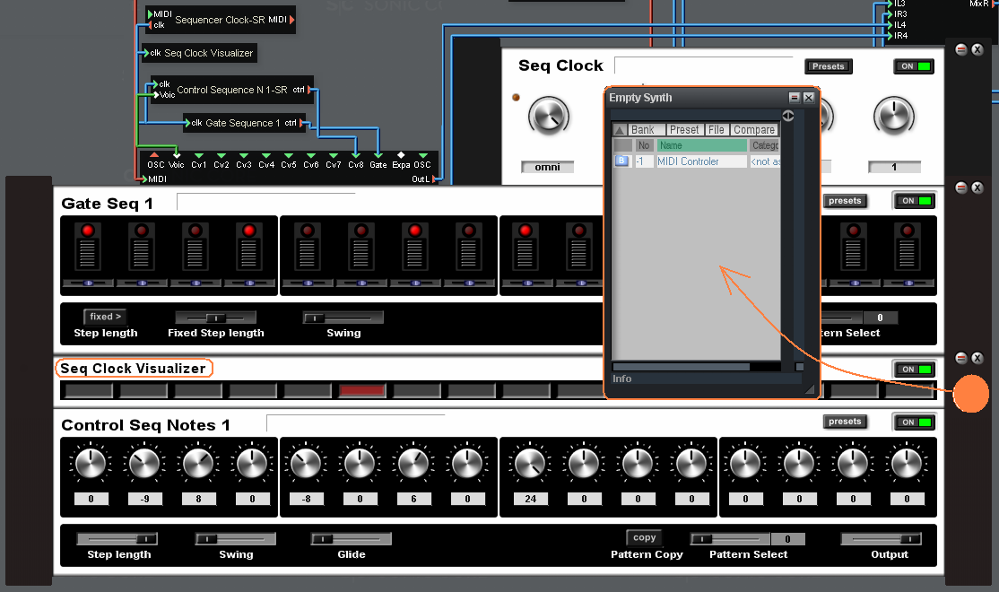

Re: CWM SeqTools (christmas is coming!)
** Visualizer - ghost button on the right cheek opens PresetList!?!
** add polymode for successful chord editing, define the voiceboards which should be editable, or link them to the destination

Ah, you've noticed! Please forgive me.Spielraum wrote: Sat Dec 07, 2019 2:18 am Visualizer - ghost button on the right cheek opens PresetList!?!
I don't have Mehdi's devices...
...but I'm sure you cannot convert Sync signals to Async signals without being totally out of sync. (long live Sync
