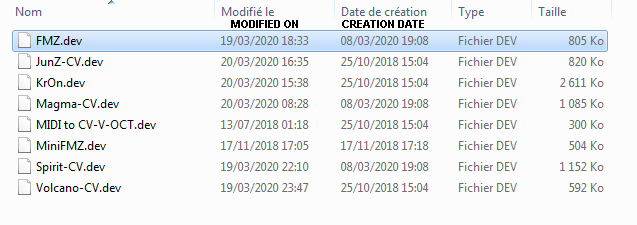

Are these update files supposed to have recent "date modified" tags because i'm showing only a few:
Magma - 1/22/2020
Filt-eq-1m - 3/20/2020
k16 -2/26/2020
kl16-2/26/2020
All other files were labeled older dates.
Also my download section only includes the BBIII files. The Kron and company files downloads are on the product pages, is this correct?

Ah yes, you probably got it before I updated the website shop. Thanks for the heads-up.
Updated the product page files , and here are the direct links for the updates:
KrOn - https://spacef-devices.com/DOWNLOADS/SpaceF-KrOn.zip
KrOn Max Pack - https://spacef-devices.com/DOWNLOADS/Sp ... axPack.zip
Here is a pic with the dates of modification/creation (format = day / month / year )
If you want me to update your shop account by adding downloadables that you purchased before the site/shop updates, I can do it for the current products that are displayed in the shop, but I sometime forget who is behind the nicknames. Also , woocommerce is not search friendly (it is slow and also GDPR limitations apply - or may be woocommerce wants me to buy a plugin for this, but I am not funded for this right now) .. For example, it is not possible to look for orders of a certain users (or I did not find how to do it). So the search process if pretty tedious.
SOLUTION ---> Please PM or email me with your name and the pack that you would like me to add (or the nickname you used on my site for the purchase), so I can do it easily and quickly. It will be much easier for me like this, and much quicker for you. Thanks a lot in advance.

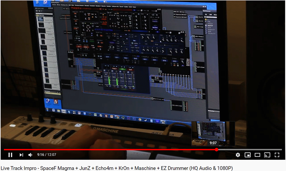

Guys, I think I upoloaded the wrong KrOn version which did not show show the T1 / T2 in mixers outputs and Quad etc. Please check and if I am right, I have just uploaded the right version online (in your accounts and on product page).
Also check this https://youtu.be/D_ysfwAaBEk
Note to myself: Magma LFO 1 & 2 'as well as EG and OScillators) are available as modulators just uinder the filters and are mixed with the CV inputs, no need to get them through the adders.... (now i will remember :-) )
Note to all: generic midi controllers are the best for scope. MAschine is cool because pots and buttons can be labelled. However, I don't do it because once the track is recorded as audio, i never save projects or presets... it's all dynamic, andthe rest is actually a waste of time to me (because when I want to do music, I don't laucnh a soft to program stuff that will make the momentum go away), except for those stuff that are permanent in the project (but i've been there, and that's not for me, as set-ups change often).
You can also check this one which is less musical, but shows that with one pot i can control the resonance of the filter and the feedback of the echo, it happens at the begining, until i change the midi cc number of the echo feedback. https://www.youtube.com/watch?v=EVW8SuVDxOA
JUNZ (aka JunZee, dʒuːnzi) : the bug that was reported concerns the drone mode Button that does not update on some presets. I still need to check wether it is only old presets or new ones too. I Hope we can cope with this until i find out, which can take a bit of time (and as long as we are informed... it should be ok for now).

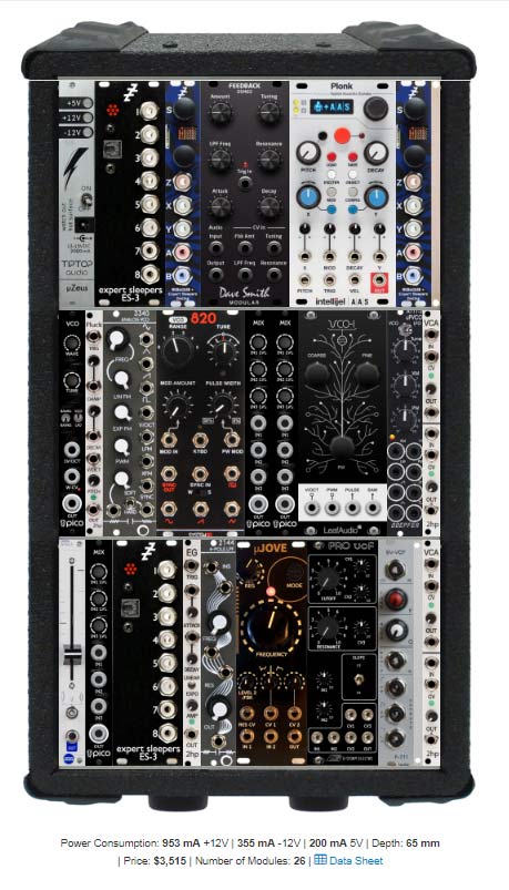

David wrote: Sat Mar 28, 2020 8:24 am Sadly only with scope synths
for the moment, i have only an ES 3 + Pico VCO wavetable for my tests, lol :-) not very interesting :-) will use next time though.
Scope oscillators are fatter & better than what i have, and allow to save money (rack below is more around 4000 euros than 3500 USD - same price as moog matriarch+grandmother, or a dozen of behringer clones) - at least KrOn saves between 1000 and 2000 € of extra modules (or more depending on brands).
I still regret selling the ms20-mini because of its dirty filter that behringer was unable to clone (K2 is *not* and ms20 at all - their 3340 osc is pretty clean though).
May be one day (having fun on modular grid website). Eurorack 100% for 1 or 2 KrOn (is it worth it? probably) :

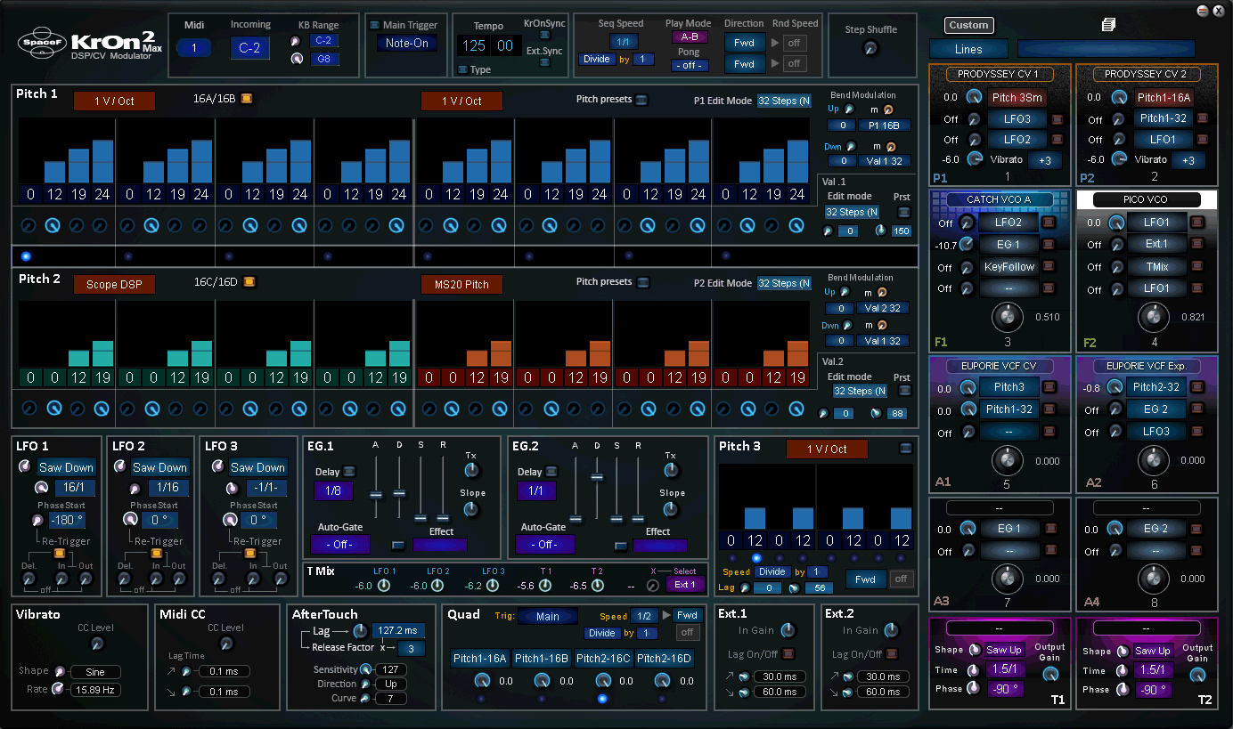

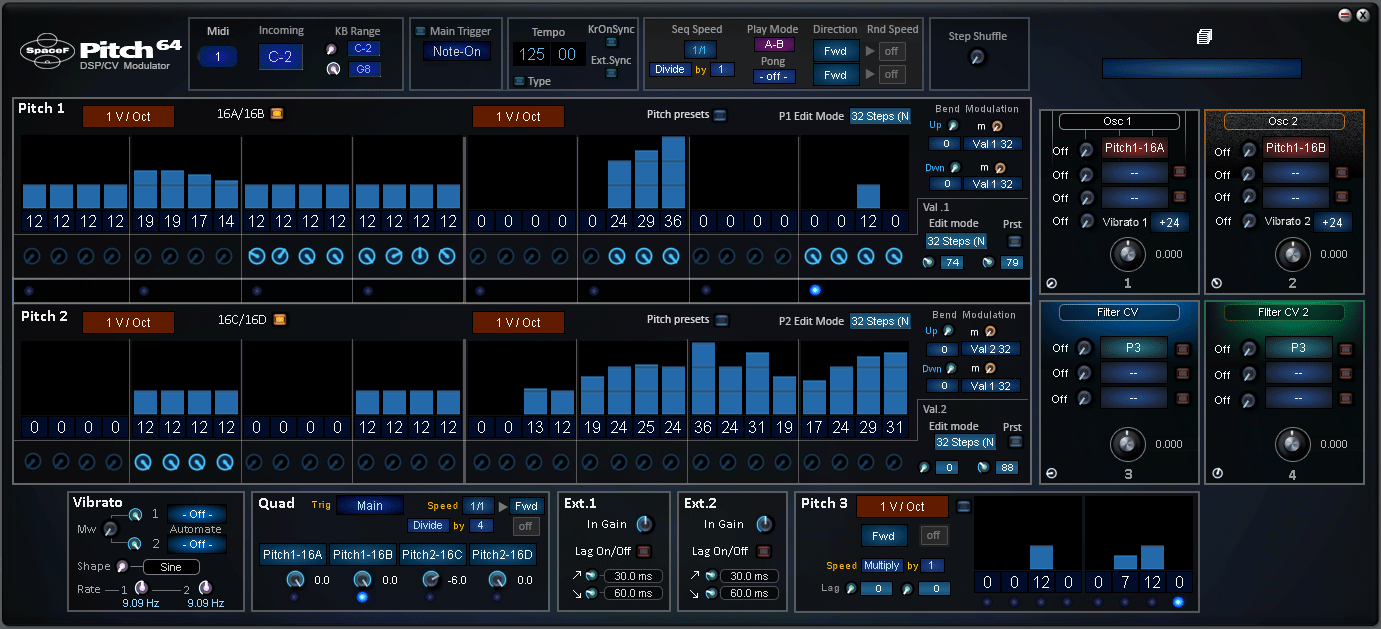

UPDATE TIME (FINAL HOPEFULLY)
KrON:
-- Corrects all overlapping pop-up menus (pitch 1 & 2) that could go behind pots and menus of the bottom sections. Many of those went unoticed by me because of diffrerence between SDK, Scope 5, Scope 7 etc. Now fixed !!
-- Graphics: BPM section graphics corrected (KrOnSync button was hiding texts, no text for external midi clock...)
-- T1 & T2 added as modulators in the P1/P2 mixers but only in the third selector. Because not having them there was totally against KrOn's philosophy (especially when *not* using P1/P2 for quantized Pitch). Now corrected, workflow and momentum are saved (as long as you remember that they are available only in the 3rd selector, which should be fine)..
-- Dual KrOnSync Output: for better project organization, the KrOnSYnc output (Bpm Output Pad) is placed at the top and at the bottom of the device. It is the same pad, just helps to have better looking routing window if possible.
-- KrOn loads with settings that make it easier to hear differences in various "play modes" (check the leds to see what notes it plays in the different modes ==> it won't do anything if you have the same notes repeating on all 4-steps sections, it is much more obvious on complex 32 step sequences: that way you should hear many differences).
--- Litterature: some tooltips were re-written for better understanding (bpm section).
JunZ
-- Added LFO Sync, BPM, internal sync, KrOnSync (no external midi clock = intentional/not important: please use external clock with KrOn or synth like Magma if you really need an external clock).
-- Internal BPM display disappears when KrOn Sync is "On". KronSync button tells you to check tempo on KrOn (it is unfortunately not possible to display the KrOn's tempo on external devices, so you have to check on KrOn if you forget what is your master tempo) (*).
-- Changed color of the audio-input insert slot to grey for better visibility
-- Audio Input send to Ring is now taken Pre-Insert. This allows to have the audio as Ring modulator while audio-in level is at 0.
-- Drone mode button display should be corrected but presets might have to be resaved for correction to happen.
-- More informative tooltips (audio-in ring led-button, kronsync section).
Magma
--- KrOnSync Inputs at the top and bottom of the device for better looking routing window (gives choices).
--- Internal BPM display disappears when KrOn Sync is "On". KronSync button tells you to check tempo on KrOn (*).
--- KrOnSYnc input renamed to "Bpm" for consistency over several devices.
--- NOTE: modulation wheel fader looks like it behave strangely when selected with the mouse but it is because it is actually a rotary knob. It is made to be used with mod-Wheel though, so mouse behaviour has not been changed (the rotary behaviour is the one with the highest resolution or easiest to use in my opinion).
Spirit
--- Drone mode button now in presets as should be.
Many thanks to beta testers who helped a lot in making this update quickly available and as complete as possible...
(*) having the tempo display disapear and leave an empty space can be confusing at first, but adding a graphic that looks nicer implies adding logical modules, controller pads, and graphic groups = additional dsp resources. In the current design, the dsp resources used = 0 ) .
Pictures below:
- it is possible to connect both outputs to different bpm inputs of different devices.
- it is not possible to connect 2 Bpm inputs at the same time. The device will not let you connect the second pad once one of them is connected ("cannot route / incompatible pads" error message = perfectly normal/logical behaviour)
Please NOTE; it is normal that KrOn displays a "division by zero " message when you "Kron-Sync it" with no master Kron BPM plugged into the Bpm inputs. when nothing is plugged in, KrOn sees BPM=0 and cannot compute the actual tempo (0 in = 0 out = impossible tempo).

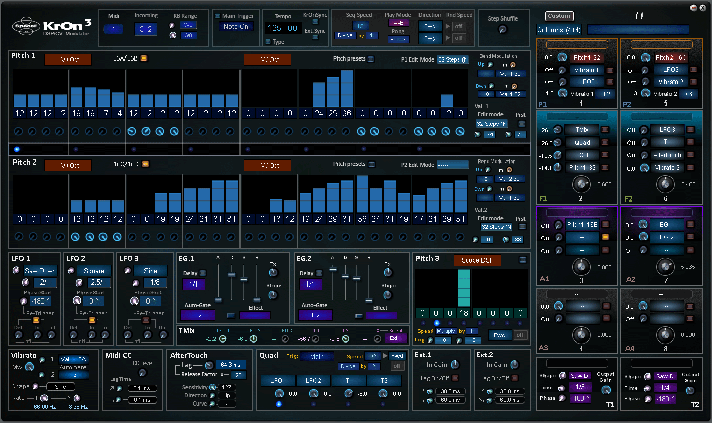

Did someone ask for a KrOn Video with eurorack stuff ?
here you go --- > https://www.youtube.com/watch?v=63dLKQ3KhXo
KrON v2 is available for download from your user account. It is the same zip as before, but it now includes 4 new devices.
For details about the update, please check this page.
I am taking a couple of days off to avoid burn-out (!) - but feel free to discuss the update here or on the spacef support section.

UPDATE TIME
UPDATE IN YOUR ACCOUNT. Please refresh the page if you do not see the download. Let me know of any problem because I changed the file names to include a date (02 08 2020, ie 2 of august 2020).
CONTENT:
- New presets for KrOn 2 / Max / Mini : they are not numerous but will serve as "'init" or starters. In the big KrOns presets, you will find a 64 steps example.
- Big KrOns: graphics: a display and a poti were appearing above a drop down menu. Fixed
- Mini KrOns: the T Mix inputs were mixed up making it confusing: fixed
- Midi to CV device: changed the name so it looks smaller in your project, fixed the midi channel which was always "omni". (the Midi to CV is used after KrOn to be able to transpose midi notes when using a midi keyboard/sequencer. You don't need to use this device if you use a CV-able keyboard directly connected to your rack, where KrOn does only pitch modulation without sending root note info. The midi to CV device is used to mix Pitch Mod from krOn with the midi root note from your sequencer or midi keyboard).
Know "bug not bug"
The following does not affect the way devices are saved in projects in any way.
So it is not a bug but might be annoying when you are not "aware" (even if you are JC VanDamme, you are obviously aware, but might be annoyed anyway)
- Presets have sometimes to be pressed TWICE to restores 0 values (click on the "P" square twice).
- This is a "bug not bug" due to the introduction of the "Null" value as a 37th note in the V/Oct format. This 37th notes might translate as a "+24" or "+37" when reloading presets in V/Oct... until you load the preset a second time. It is a bug because it might be bugging you, but not a bug because it is the way it is supposed to work (well, the only way it can work right now).
- I will let a month for all to test the Null function and we will decide together in september if I remove the Null Value, so the "bug not bug" will be fixed and presets will not have to be loaded twice. This can be annoying for those who want to change presets with Program Changes wich is another powerul function of KrOn...
- so for now, please press the "p" icon near presets twice to be sure the presets are restored the way you saved them ( :-/ ) .
That said, I have tested several native apps for controlling hardware through CV, and I am not ashamed to say that KrOn is top notch in terms of flexibility, number of modulators, timing reliability, easiness to mix several modulators, variety of modulators that are actually useful and can make it into final production, presets... etc etc :-)
A couple of audio demos of the included presets:
---> https://soundcloud.com/user-442800355/s ... 2-eurorack
- The first preset is a 64 steps melody. It shows that KrOn is great to lay down the basic of a track. then you add stuff or do solos for fun. It also uses a SpaceF Ambient Delay on one of the oscillator, with an SC AutoWah in the "Main" insert slot.
- the third preset shows random pitch: it is the same melody as in the first audio, but in random mode.
String/pads are made with SpaceF Osc in Pigment 2.
The 3 audio are made with the same midi. they use the new preset delivered in the zip, controlling 2 eurorack oscillators + 1 filter + BB3 filtEq1 in Scope on one of the oscillator.

Game of Thrones in KrOn
Preset (screenshot) and demo
viewtopic.php?f=17&t=36565&p=345931#p345931
trance jamming
https://www.youtube.com/watch?v=17alpVhhBqg

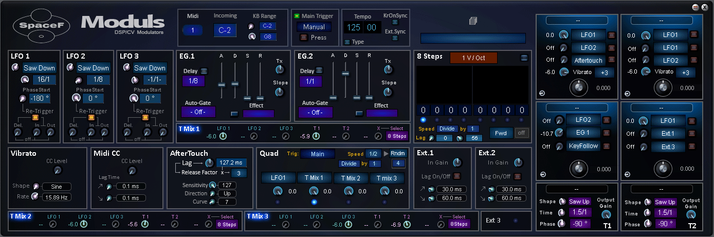

KrOn 3 is available for download in the user area.
---> Added Devices : Moduls and Pitch 64
---> KrOn 2 still available in the zip files (folder "Legacy").
Please download from your user account. As usual, let me know if there is any issue dowwnloading the update (the zip name has been changed to reflect the date of the file).
---> BIg change in philosophy; the presets recall everything including the type of signal ( DSP or V/Oct or Hz/V).
From now on, the main device is KrOn 3 , with DSP and V/Oct only (as Korg themselves abandonned Hz/V). Hz/V is still available in KrOn 3 "max" and MIni KrOn.

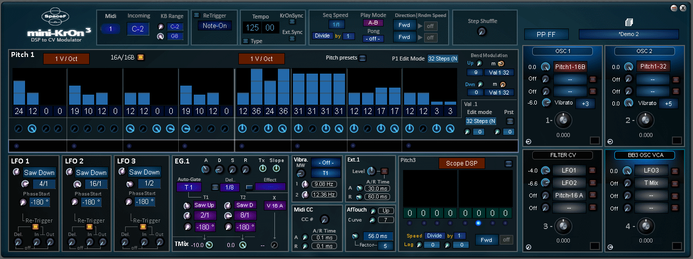

Mini KrOn 3 is also available as a BB3 device (requires a BB3 activation key) @ 29 € instead of 49 € until end of october.
With an xite @44.1hz , you load 2 KrOn 3 + 1 Mini KrOn + Moduls+ Pitch 64 = 8+8+4+4+4= 28 modulator outputs + 6 T1/T2 (T1/T2 are LFOs with their own output...which I did not remove because having those extra outputs prooved useful in several projects).
- Moduls and Pitch 64 should allow to "re-create" a KrOn in 96 khz setup (let me know if not, I can remove a few stuff in Pitch 64 to make it lighter). Pitch 64 is also nice for trigger & gates.

I Just uploaded KrOn 3.1 (29 10 2020) that adds Hz LFO and brings corrections to the preset system. You should be able to load KrOn 1 and 2 presets too.
There are 72 new parameters (mainly to "secure" the sequencers parameters), so it is normal that any previous preset list shows a "xx% not compatible" because they don't have the new parameters. Just click "yes" to load the preset list. A good idea is to resave important presets in the new KrOn 3 format.
You will aslo find KrOn 2 in the Legacy folder in case you need it.
Also, for more confort in new projects, the signal type is back to not being recalled (just like it was before in KrOn 1 & 2), so any preset can work in your current project which is more powerful and fun than having the total recall. And you also have the output labels to remember what was the destination of each output anyways.
Available now in your user area. More info ---> https://spacef-devices.com/news/kron-3/
