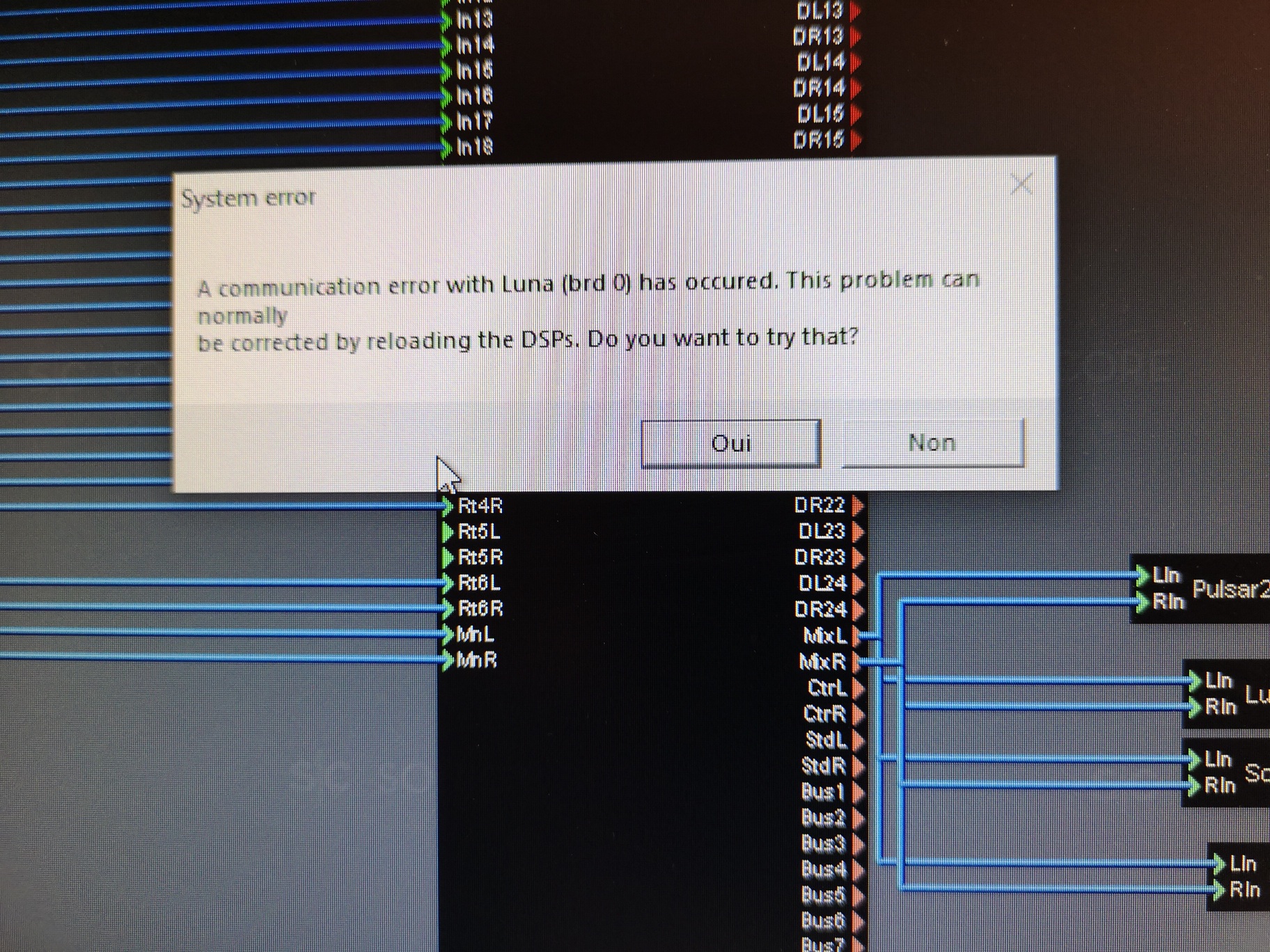

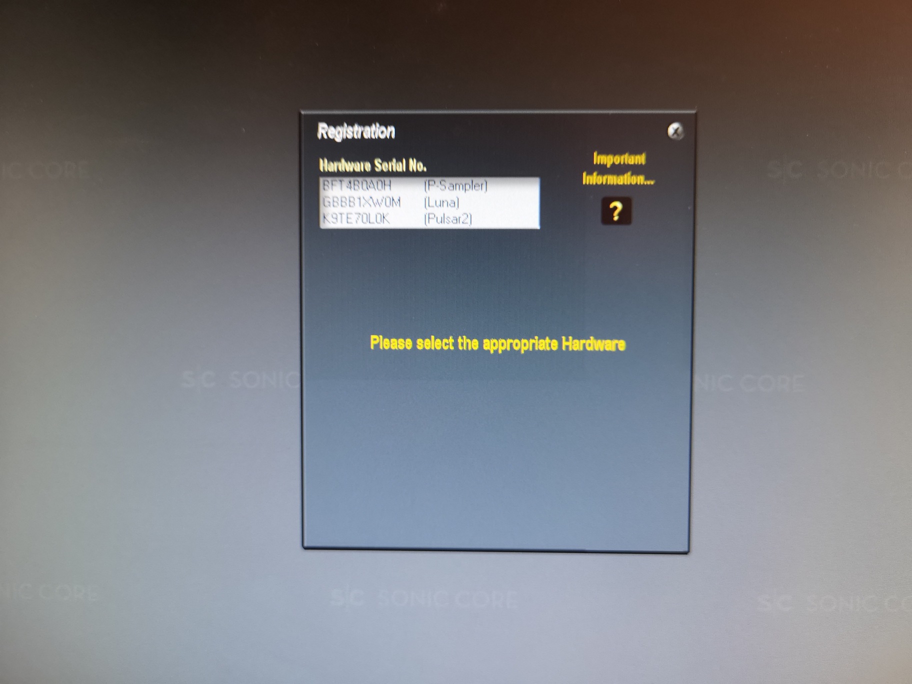

I just acquired a Power Sampler coupled to a Luna and a Pulsar 2.
Having only one PCI slot on my motherboard, I put the cards in a PCIe to 4 PCI expansion box (see picture).
Nothing works, error messages including repeated registrations but no sound, I think it's a problem of insufficient voltage to powered the 3 cards.
Is there anyone who's ever faced this problem before?
Are there more stable solutions in PCI extension?
thank you
thank you

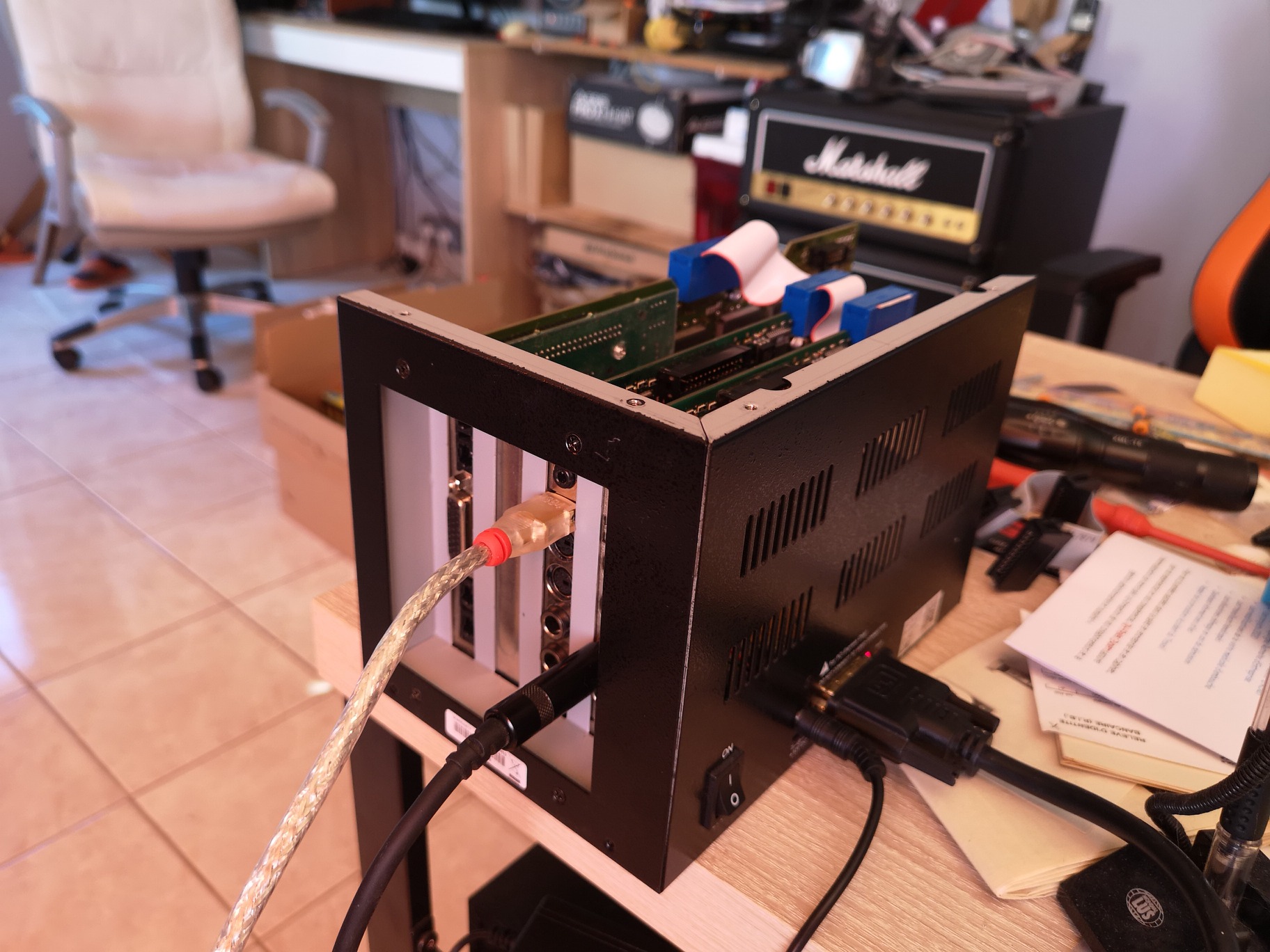

- IMG_20200528_184012_resized_20200528_072137777.jpg (442.73 KiB) Viewed 6737 times
- IMG_20200528_183948_resized_20200528_072138070.jpg (341.41 KiB) Viewed 6737 times
- IMG_20200528_183834_resized_20200528_072137003.jpg (954.07 KiB) Viewed 6737 times
- IMG_20200528_183824_resized_20200528_072137337.jpg (902.07 KiB) Viewed 6737 times

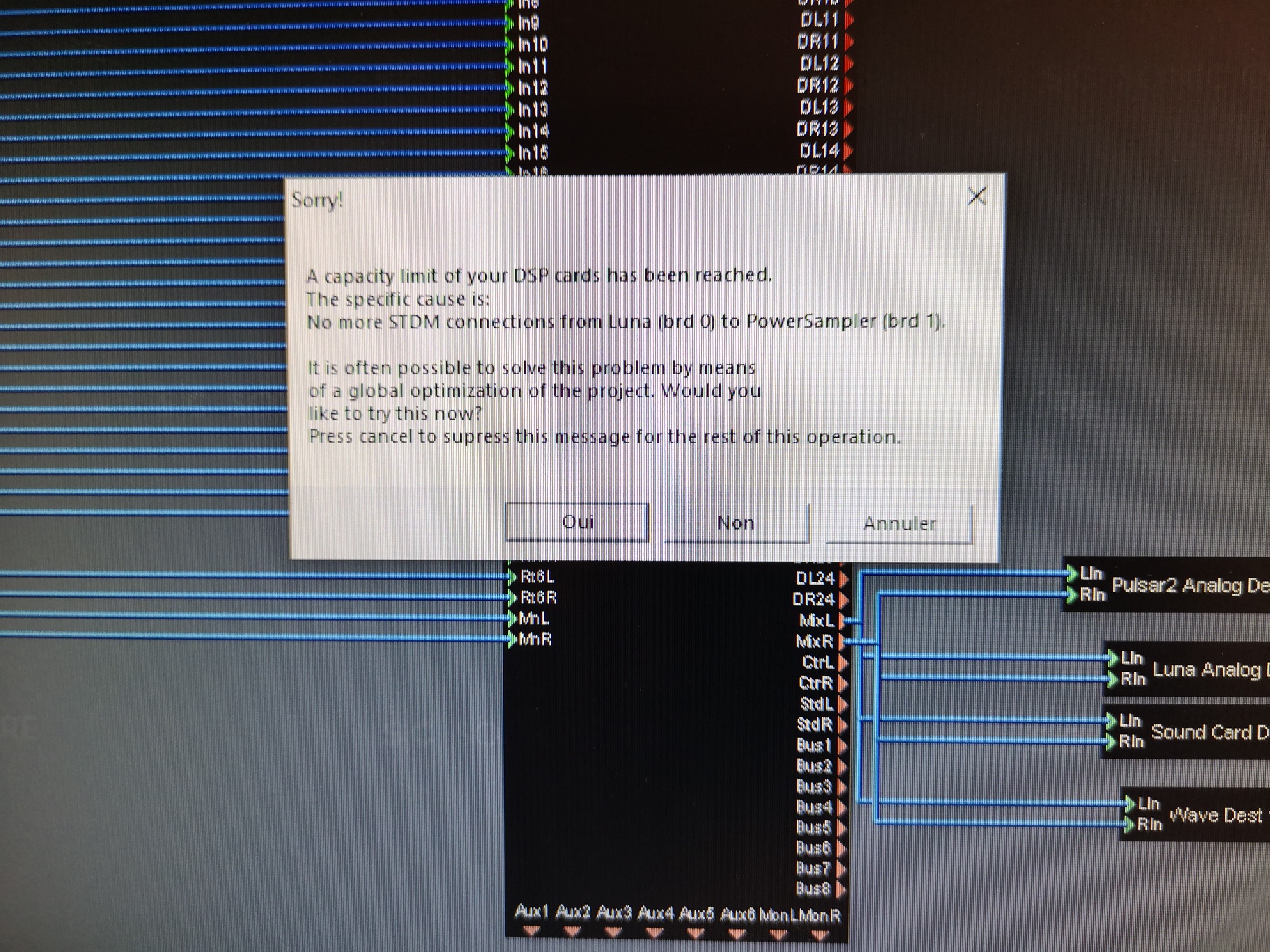

Does it work with just 1 card in the expansion ? With 2 boards ?
Try to replug the STDM-cable or use different connectors on the cable.
You could also use an empty project. This doesn't drain so much power like a fully loaded project.

Most PCIe > PCI expansion chassis don´t work as expected for SCOPE cards.
Possibly a Magma chassis does.
Re: voltage problem with 3 cards ?
not enough power.
expansion boxes suck.

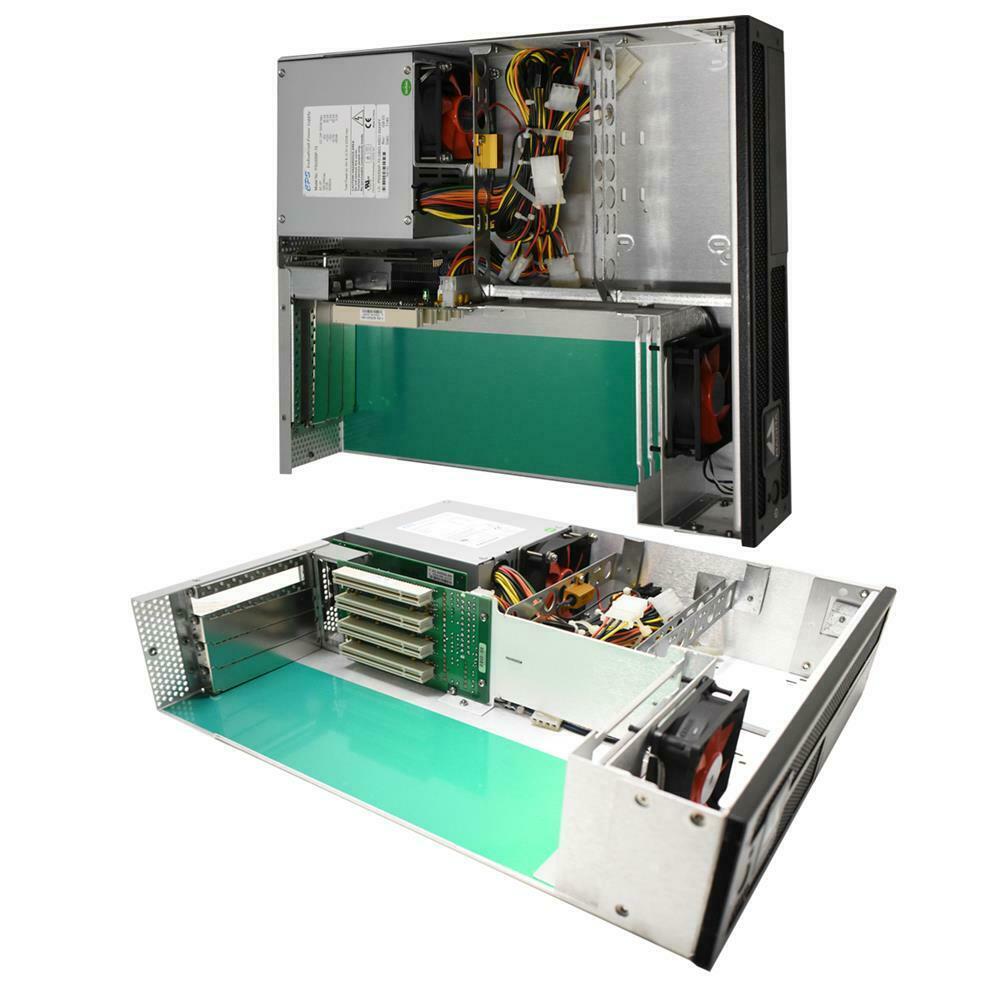

Thank you, pranza, is this the kind of chassis you recommend?

- magma.jpg (77.62 KiB) Viewed 6585 times
that might work, but cheap expansion boxes generally are not that good.
even a magma box will significantly reduce the PCI capacity.
a new motherboard is quicker and cheaper.

I own this magma box shown in the picture.. I also own a magma 13pci-slot board.
Both seem to work with scope cards. ( tested with scope 4.5 and pulsar1 and 2 cards. )
I can use a pcie, pci oder expresscard on the pc-side to connect to magma.
But as gary said, the pci-bandwidth is lower compared to a mainboard with pci.
With the famous masterverb-test I got 4 verbs, but I was able to fill all DSPs with synths.

Strictly East, yes, that's the one i have but they come in more flavours: older generation, different amount of slots, 64bit pci card support...
i can do 7 Masterverbs on this one with a single 14dsp card.
Speaking of motherboard 'native' pci capability vs magma boxes i'd say for current hardware it doesn't matter as there weren't any pci compatible desktop chipsets for almost a decade already. Even when they were available, not all implementations were as good as what magma offers. Nowadays if you get a motherboard with PCI slots it means PCI bridge being on-board. Rare thing that you get a mobo with PLX pci bridge (that's a good one that magmas use). Most often it's an ASMEDIA or NUVOTON or ITE - second tier and it's a further gamble how they are implemented.
I reckon most reverbs-capable pci chipsets come from pentium iii age. Even then I had problems with Scope. It has many possibilities and many unsolved issues so no matter how old a system you get, you'll still have issues. On the other hand if you're smart, you'll find a way around those issues and make your Scope work even with latest hardware.
Now concerning a fact that you already have that chinese pci expansion at hand it would make sense troubleshooting it. If it's just a voltage issue you can solve it, or maybe a friend can help... It can be something else though, try just one of the cards in every slot in a row and confirm it works... Also a smallest card, then a bigger card... then two of them.. It can very well be that a pci bridge solution itself in that box is flawed... and only if this is confirmed, it's time to move to magma...

Luna 2, power sampler and pulsar 2 in the Magma box.
It's very stable.
The whole thing plugged in Zlink on the A16 Ultra, I could record 10 tracks simultaneously (reason why I added a power sampler because the AdatB of the A16 doesn't work).
I haven't really tried with the plugins yet but so far everything's fine.
It's very stable.
