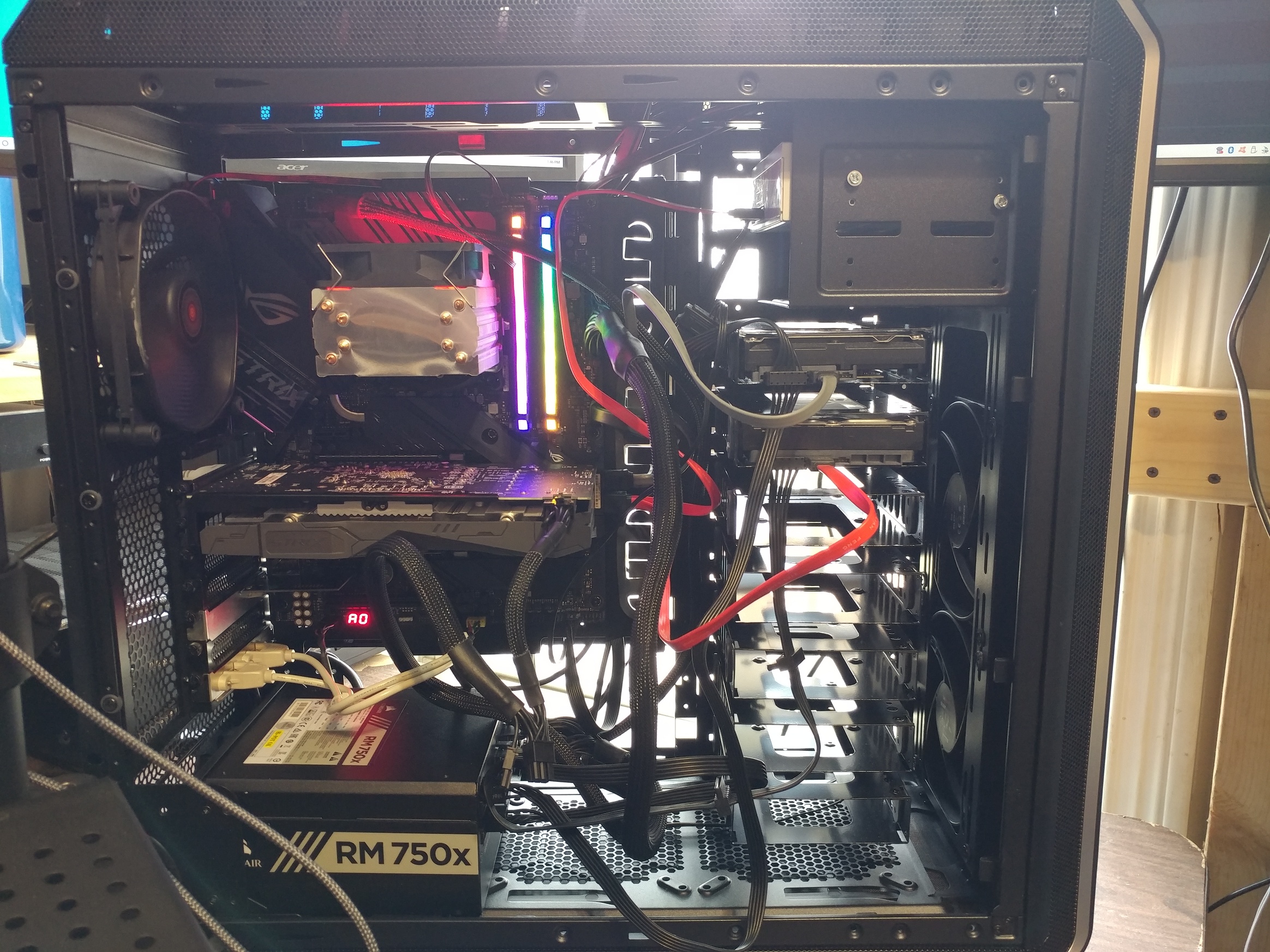

Here are the specs on my new computer. (very similar to Katano's build) Still testing but appears to be working just fine with Xite-1.

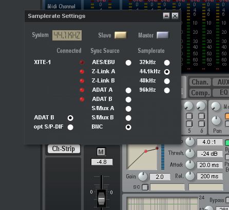

The only snag was when I put the Xite-1 PCIe card in 1X slot #1, the BNC would not sync to the master clock. When I moved it to 1X slot #3 it synced up just nicely. (I think the fist slot has different specs than the rest)
Also a very strange noise seems to be coming from the computer thru the Xite-1 PCIe/HDMI cable to Xite-1 XLR outputs. (Confimed it was not going internal by checking via the Xite-1 headphones out and no noise.)
It is barely audible but noticeable when I crank up the volume on my mixer all the way. Sort of scratching noise when the hard drive is accessed and even when I move the mouse although to a much less degree. When i play an instrument at a normal volume I do not even hear it and as long as it is not recorded I suppose it really isn't worth troubleshooting but thought I'd post it here for folks.
ASUS ROG STRIX Z490-E
Intel Core i9-10900K 10-Core 3.7 GHz LGA 1200 125W BX8070110900K
CORSAIR Vengeance RGB Pro 32GB (2 x 16GB) 288-Pin DDR4 SDRAM DDR4 3200 (PC4 25600) Intel XMP 2.0
ASUS ROG Strix Radeon RX 570 DirectX 12 ROG-STRIX-RX570-O8G-GAMING 8GB 256-Bit GDDR5
Sabrent 2TB Rocket 4 PLUS NVMe 4.0 Gen4 PCIe M.2 Internal SSD Extreme Performance Solid State Drive R/W 7100/6600MB/s
be quiet! DARK BASE 900 ATX Full Tower
Corsair RM750X PSU
Windows 10 Pro 64-bit
WD Easy Store 10TB external USB and a couple of SATA hard drives from my last computer.
Oh yeah, one last thing if you are looking at these ASUS Z-490 ROG Strix motherboards. Be careful of the heat sink you buy because the CPU slot is very close to the RAM slots. I had a new heat sink sitting on my shelf that I installed and the mounting brackets extended out over the first 2 DIMM slots. I was able to bend the wing clip off to use the second DIMM slot but I have a water cooler heat sink on the way in case i want to utilize all 4 DIMM slots.
-Also If you are installing one of the new NVMe SSD's on this motherboard, there is a preinstalled heatsink and on the underside is a thermal layer with a plastic strip on it for protection during shipping. Make sure you peel that plastic strip off. I did not since there was no instructions that told me to to so but for some odd reason I decided to double check and luckily averted a possible thermal condition episode.
Whew!
Prefabricated back panel of the motherboard is a nice feature and seals it up perfectly w/o having to fiddle with those old metal cutouts.

nice! 👍🏼💪🏼

... when I put the Xite-1 PCIe card in 1X slot #1, the BNC would not sync to the master clock. When I moved it to 1X slot #3 it synced up just nicely. (I think the fist slot has different specs than the rest)
Ooops,- I thought BNC Sync is broken in SCOPE v7.0 (x64) ...
Which SCOPE version do you use ?
yayajohn wrote: Wed Dec 30, 2020 10:53 am Also a very strange noise seems to be coming from the computer thru the Xite-1 PCIe/HDMI cable to Xite-1 XLR outputs.
That´s not normal IMO,- at least I don´t have that w/ the older PCIe card using DVI to HDMI connectors.
Did you try a different HDMI cable already ?

Hey Bud. Not sure about the BNC. I think it is broken if you want to use the Xite as a master clock. Mine seems to work in slave and yes it is Scope 7.
Thought about the HDMI cable as the source of noise, I may try that before I shove it into it's final resting place for a decade hopefully. I ordered a bunch of USB 3 cable extenders. I'm going to build a break out cable so I won't have to try and crawl under all my shit and bang my head in the future :lol:
Now comes reinstalling all the crap.......uhhhgg!

yayajohn wrote: Wed Dec 30, 2020 2:53 pm Hey Bud. Not sure about the BNC. I think it is broken if you want to use the Xite as a master clock. Mine seems to work in slave and yes it is Scope 7.
Excellent news !!!
I didn´t try because I might have misunderstood somewhere here @PlanetZ some time ago.
Now I will, because I want all the digital gear be slaves, except the masterclock I bought.
