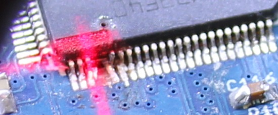

Put the card on a table and use some maginfying instrument. The legs of the DSP-chips are separated in 0.5mm. They should not contact each other ( a minimal space is fine ). The legs need to be connected on both sides, too.
In an electronic lab, you also test the connection of the pins by touching them, which you should not do, unless you know how to solder SMD !
- IMG_2625.small_.jpg (64.2 KiB) Viewed 4898 times

Put the card on a table and use some maginfying instrument. The legs of the DSP-chips are separated in 0.5mm. They should not contact each other ( a minimal space is fine ). The legs need to be connected on both sides, too.nebelfuerst wrote: Sat Jan 16, 2021 10:57 pmHow do I do the latter?nebelfuerst wrote: Sat Jan 16, 2021 1:55 pm I recommend to check all legs of all DSPs for shortcuts and disconnects.
What I am feeling right now is that it should be a really silly something that is broken.... but the difficult thing is to find out which one exactly.
[/quote]
I did it, and there is no sign of any broken contact or anything like this. I think Gary is right, the problem seems to be in one of the capacitor.
