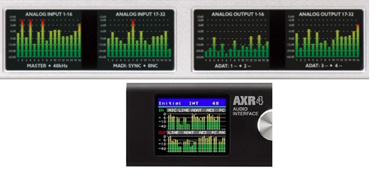

Re: Review Steinberg AXR4T
I like the way they incorporated the Ferrofish LEDs and correlate them to the I/O’s.

dawman wrote: Tue Apr 20, 2021 7:48 pm I like the way they incorporated the Ferrofish LEDs and correlate them to the I/O’s.
Yep theres an aftermarket opportunity there for sure for class compliant Steinberg USB Magnifying Glasses. They could promote those in NYC with dooby and vacine giveaways. :lol: :lol: :lol:
dante wrote: Thu Apr 22, 2021 12:45 pm
I guess the as long as it doesn’t blink red it don’t matter the color. :D
Its a no brainer....
LCD Screens
LCD Screens
